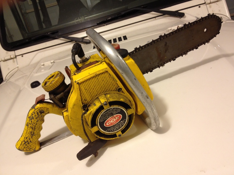

Got the bar and chain on. The pull handle has been replaced. Other then that, I need to double check the fuel lines as 2 lines are not connected. I'll have to figure out where they go.

WingingIt74 wrote:Got the bar and chain on. The pull handle has been replaced. Other then that, I need to double check the fuel lines as 2 lines are not connected. I'll have to figure out where they go.
Be sure the fuel lines can tolerate gasahol.
Just a Little Teaser :) - My New Cox Chainsaw Empty Re: Just a Little Teaser :) - My New Cox Chainsaw
Post  WingingIt74 Thu Sep 13, 2012 9:56 pm
Good point. When it was new, I don't think there was unleaded fuel either.

Those red wooden replacement pull handles must have been popular, this one has one too.

Was watching this one. The best conditioned one I have seen to date, with all of the manuals and tags.
The really rare ones have a picture of a beaver chewing on a piece of wood on the pull start side plate along with the Cox logo.
They have engine vacuum assisted chain/ bar/sprocket oiling, make sure those lines are correct or you will seize the sprocket tip on the bar and peel metal off of the bar with the chain zinging. In a pinch Trravis, you can dribble some 90WT gear oil on the bar and chain when you run it (if).

PV Pilot wrote:They have engine vacuum assisted chain/ bar/sprocket oiling, make sure those lines are correct or you will seize the sprocket tip on the bar and peel metal off of the bar with the chain zinging. In a pinch Trravis, you can dribble some 90WT gear oil on the bar and chain when you run it (if).
There is no sprocket on the tip of the bar.
Interesting, just checked mine and one has a sprocket and the other does not. apparently a bar swap at one point in its life.
