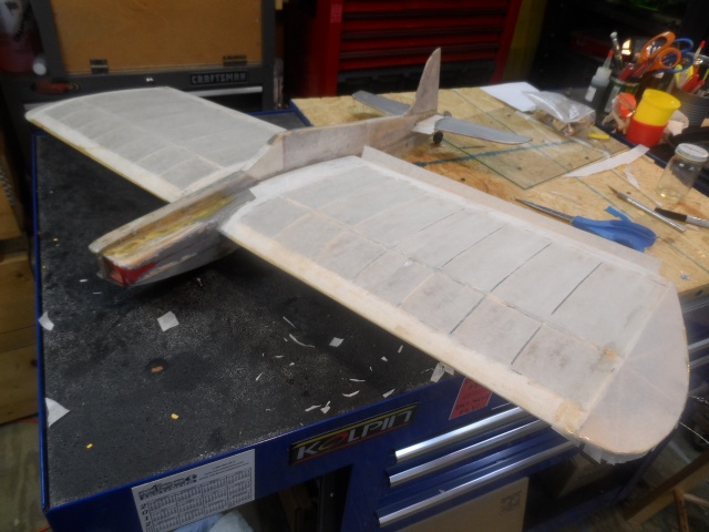

Post  pkrankow Mon Jun 17, 2013 6:31 pm
I got paint on my repairs today (Finally!). I masked the wings, which were (ahem) covered and finished. It rained, but the paint had already flashed dry so the paint was OK. When I pulled the mask the film came off the inboard wing root top and bottom. It is looking good otherwise. I have enough red to repair the wing, but not to recover the wing entirely.
Kinda sad. Slightly upset...
Still need to re-do the yellow trim on the stab, but that will wait a couple days so the red gets good and hard. It will also involve a fresh roll of 3M blue tape because this green "frog tape" sucks with rattle can paint (it is meant for latex paints), and when it gets rained on it won't let go of shrink film.

Post  pkrankow Sat Jul 27, 2013 11:03 pm
OK, paint is done. Engine broke in. Wings fixed. Near flying trim, must balance prop properly.
The muffler makes it quite nose heavy balancing between the LE and the lead out. I am OK with this for the maiden flight, should be predictable...
I broke the engine in on an old 10x? topflight prop, this is a new master airscrew in 10x6. This prop size is recommended by Fox for the engine, a Fox 35 Stunt.
I have a half-sheet of linoleum on lauan that I plan to cut into two 2 ft x 4 ft strips and put the brodak stooge mechanism onto.
