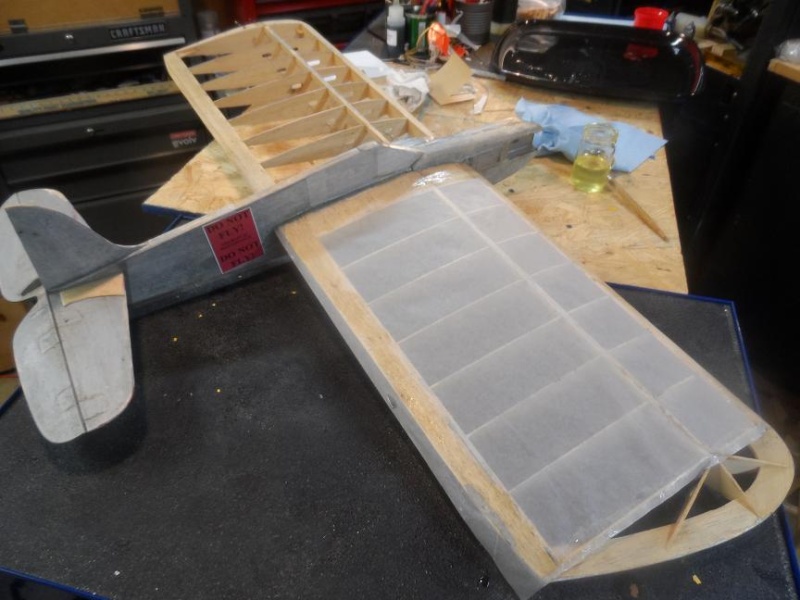

Beaten into submission after accidentally puncturing the remaining original silkspan on the Ringmaster, I cleared out a bigger area and got out all of my covering stuff. The Super is now getting a new layer of silkspan all around.
Also took a patch of the original silkspan to work and had one of the girls match it up to the Brodak chart. So now, I'm clear coating and waiting on a Brodak order of "Caribbean Turquoise" and "Aeronca Orange" !
My Swap-Meet Ringmaster !  Smack Down!!!! The Resurrection  Begins!! - Page 2 1_164
While the silkspan and dope was flying, I figured I might as well ALSO start covering my Uncle Wayne's Goldberg Buster. So the Skunk Works REALLY smells like airplanes now !
My Swap-Meet Ringmaster !  Smack Down!!!! The Resurrection  Begins!! - Page 2 2_115
My Swap-Meet Ringmaster !  Smack Down!!!! The Resurrection  Begins!! - Page 2 3_96

It's for the best, otherwise you would have been chasing punctures over the whole wing. Kinda like ripping a band-aid off. Very Happy
Looks great though. Kind of makes me want to give silkspan a go. Kind of........

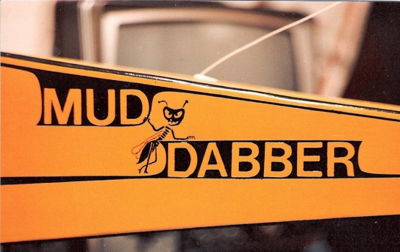

Thanks Ron ! Yeah. Sometimes, I can get a major case of "Stupid", but it's usually short lived ! I thought it'd be great for the old plane to fly with at least some of it's original glory but the covering had the strength and texture of a dried leaf.
Also, if anyone can point me to a source of silkspan, I'd appreciate it. I think I bought the last of Sig's medium and heavy, and couldn't find it listed on Mr. Brodak's site.
I'm sure most people see it as an archaic covering method, but for me, it's as much a part of the hobby as flying the silly things, and when I finally finish one, there's a lot of "ME" instilled in the plane (for better or worse!).
I cut the silkspan to about an inch oversize, and lay the sheet in a cookie pan of water, while I clear dope the perimeter of the frame. Once the dope is dry, I blot the silkspan on my pants leg (yeah, but I dry out quick) so that it's just damp, lay it across the frame, drawing it out just so any major wrinkles are gone, and dope it's outer edges. On lighter frames, I do both sides as closely together as possible to minimize warping, sometimes wrapping the silkspan around in one piece, if the planform of the wing allows.
With the Ringmaster and Buster's bridge-like wings, I didn't worry too much about warps, but just hustled along anyway.
Once it's dry, I hit it with coat of full-strength clear to lock everything down. That cures overnight, then I keep clear coating 'till I get a reasonable shine, finally ending with color and masking on whatever. I also ofter cover the solid wood structures with a layer of light weight silkspan, which masks my assorted gouges and missteps! I've done this for decades, and it allows me to instill some REAL individual expression in my flying machines!
My Swap-Meet Ringmaster !  Smack Down!!!! The Resurrection  Begins!! - Page 2 Mud_da24
My Swap-Meet Ringmaster !  Smack Down!!!! The Resurrection  Begins!! - Page 2 Mud_da25
My Swap-Meet Ringmaster !  Smack Down!!!! The Resurrection  Begins!! - Page 2 Strike16
My Swap-Meet Ringmaster !  Smack Down!!!! The Resurrection  Begins!! - Page 2 Strike17
Sorry for the novel...the Folgers has me cranked up already!
