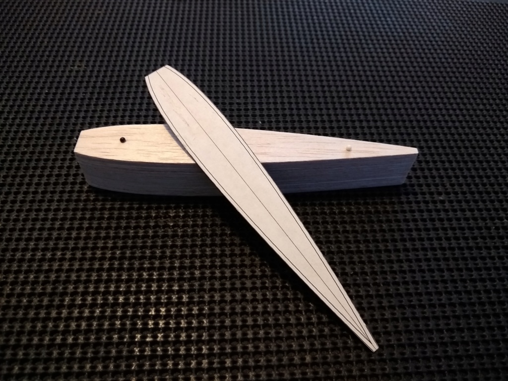

Post  andrew Wed Jul 14, 2021 6:13 pm
getback wrote:OK Do you cut on inside of the line or the outside ?
For me, I tend to cut just outside the line, then final sand to shape -- this applies to all parts.  I also do the same as Ken with ribs.  Cutting slightly fat gives me some sanding leeway and lets me remove those invariable nicks and flat spots.  Just make sure your top and bottom rib are the correct shape since they will determine the sanding pattern.
The attached picture has a rib stack and the original pattern I used to rough cut the blanks.  I print the rib pattern from either Airfoil Tools or Profili, glue the pattern to a piece of Formica laminate, then cut and sand to shape.  The formica is hard and I can use an Xacto or razor blade to zip around it. I have several sanding bars from the old Great Planes site that I use for finish sanding.
