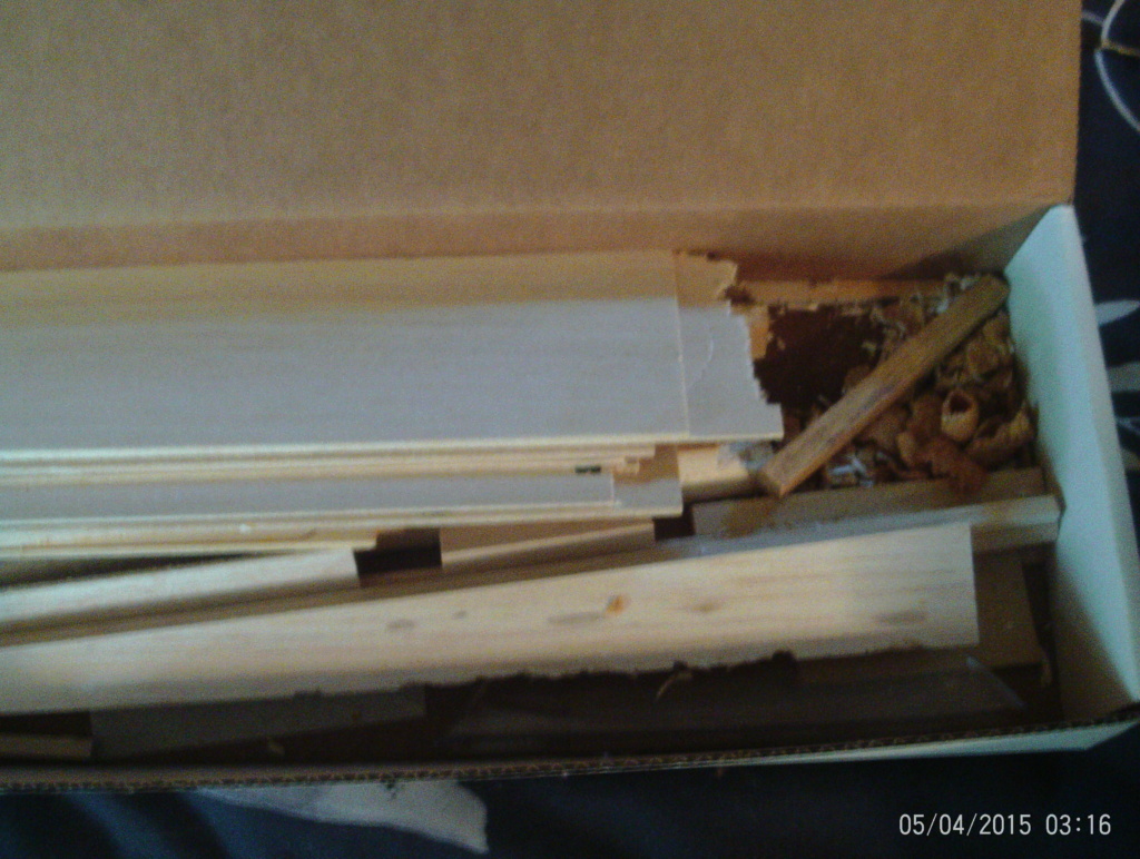

Well after reading that i thought well i haven't seen this kit in awhile and got it out to find THIS
Never seen these sites till now (Airfoil Tools or Profili) Interesting ! Damn Rats but it is die cut and that don't make since to me ? / Guess my memory ant what it use to bee LOL Now to see if there is enough of the parts to build it even though i don't have the time right now .
Thanks for the advice anyway i still think i have something that is Print !!

Eric,
What are you missing? I will be making templates of everything before I build mine.
I did note the rib sheets are light, the plywood is thick, and the tail group is on heavy/hard balsa.
