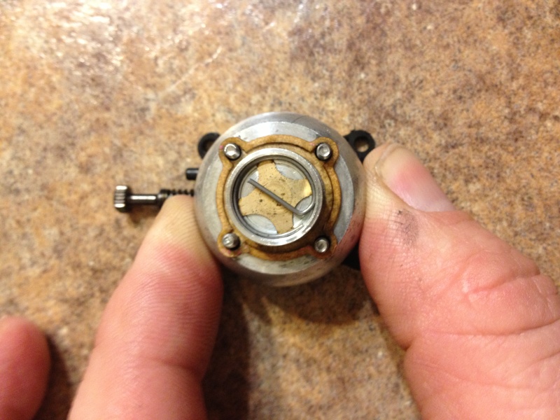

Post  WingingIt74 Sun Jan 20, 2013 6:24 pm
Here is a pic of how the gaskets interact.
Die-cast Crank Case on a stunt tank... issue Img_3311
WingingIt74
WingingIt74
Posts : 3189
Location : Waterloo, IL

Post  WingingIt74 Sun Jan 20, 2013 6:33 pm
pkrankow wrote:Can the plastic reed retainer be used with the metal tank?
It does and doesn't, as only the tip of the tank venturi will fit. I was thinking the same thing. I think if you trim one down, just for the plastic gasket, it may work.
Die-cast Crank Case on a stunt tank... issue IMG_2410
WingingIt74
WingingIt74
Posts : 3189

Post  WingingIt74 Sun Jan 20, 2013 9:09 pm
the same shape as the top gasket shown below.
