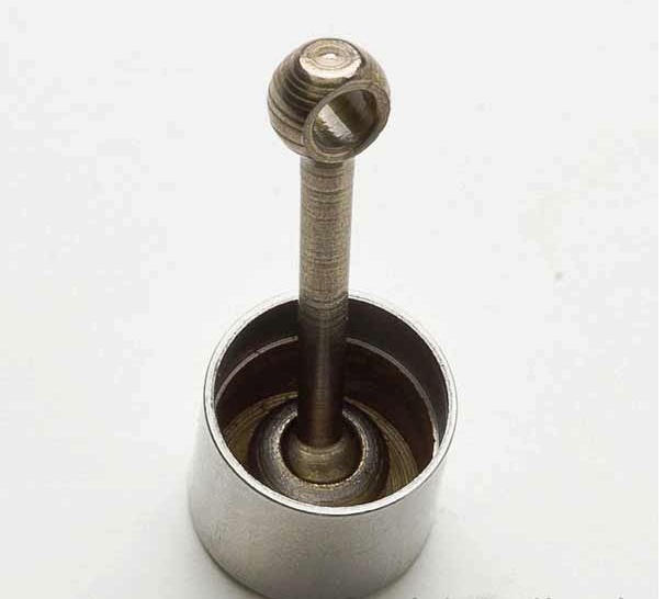

The piston on the right is lightned and on the left is standard. Not sure if this even helped my mouse engine at all.

I've found good performance using the shortened, lightened piston and Sure Start cylinder combo from Cox International.
They have been in my Tach Race engines for the last three races. I tested many piston, cylinder combos always with 25%N and 5/3 prop as a baseline and keep coming back
If and engine won't spin up over 18K on normal compression I set it aside and move on. Tried TD with four boost flutes, TD with two boost flutes and Killer Bee combo and
none did as well as the Sure Start. That said, I keep losing so I'll have to try something else next, I'm going to look at the older #1 Black Widow set, the fit seems to be better than the newer sets. Two Cents  You sure would not want to shorten a piston cly. set that comes with SPI. All my tests were done on reedies,  could you spin a TD up to 28K with less prop and more nitro? Hot  Hot

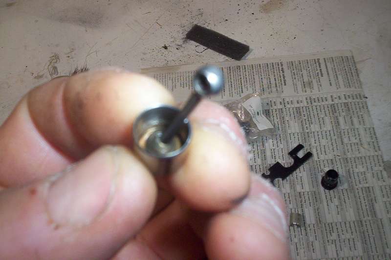

hea Crankbedr is that one u cut down? it lokes good and seems in the pic the piston still has a lot of meat at the skirt end ,  Huh... well thanks for the replys guys ,Mark I have been using and have printed the Paul Gibeault article I am sure they would know the tricks that will last the longest and perform the best. Thanks Am going to still put my hand to it just to see what I can do with it, have a drill press and old blades ..tubing / tape ??  Laughing

I don't have the skills to do this, that piston came as a set from Cox International
