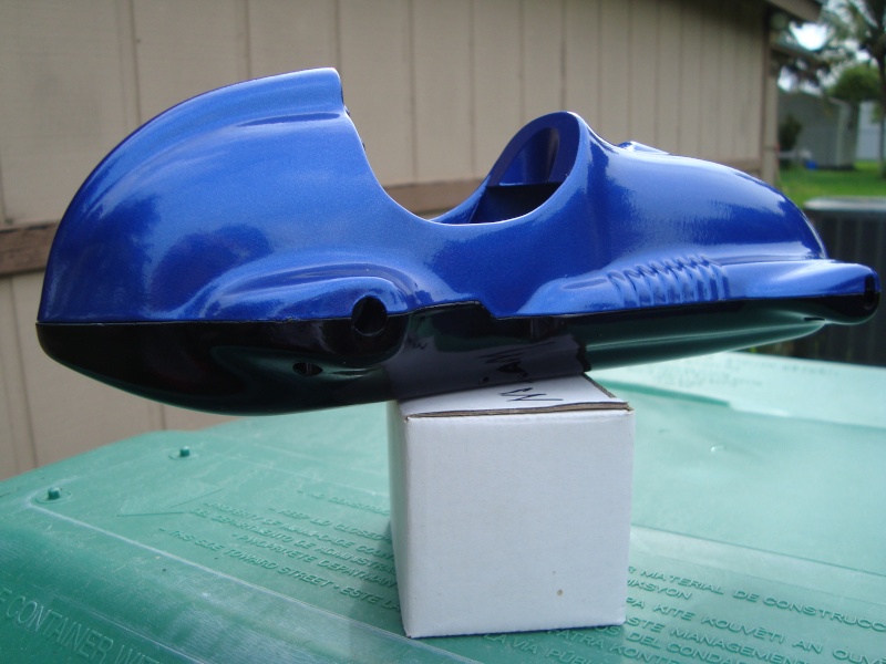

crankbndr wrote:Got the body painted and cleared today even though it is very humid here and downright hot.
I used colors close to original although the black is metallic. Assembly coming soon.

Very NICE Crank , the blue metallic came out good , what paint did you use ? getback Small Cox Logo

Thanks, the paint is Dupli-Color Perfect Match (its a Ford color) and their clear in the auto stores, definitely not fuel proof but my shelf queen won't care.
I have used that two part K2 clear over Duple-Color in the past and it should be fuel proof but haven't tested it yet.
I also tried Brownells Aluma hyde clear that is so-posed to be epoxy based over Duple-Color and it wiped right off with 30%.
Still looking for a good clear to go over Duple-Color, K2 looks promising but need to test it.
Very happy with the body, I was lucky it had no cracks dings or dents.
