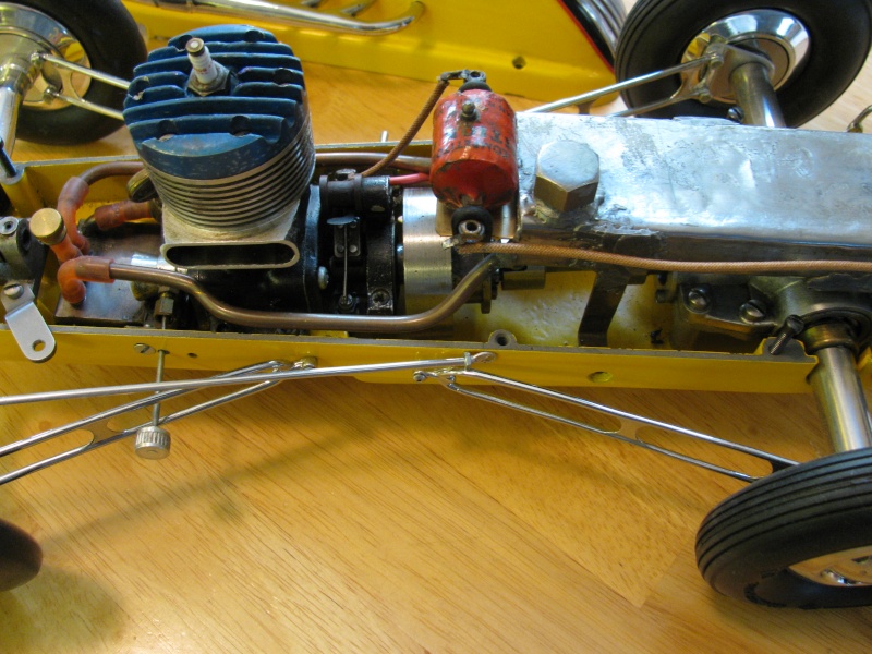

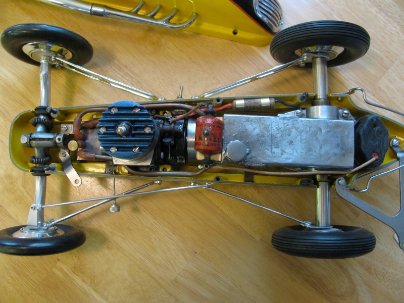

Post  crankbndr Sun May 18, 2014 11:02 am
I started digging into the Dooling not long ago and there is a lot going on inside.
In the rear is a battery pack, very large fuel thank set over the rear gear housing. To the right of the fuel tank is a condenser, the coil is in front of the tank over the flywheel and driveshaft.
The McCoy engine has a high compression head (blue), in front of the engine is an aux. fuel tank.

Post  crankbndr Sun May 18, 2014 12:04 pm
I don't understand how it works yet but the front aux. tank keeps the fuel from the main tank from flooding the venturi. The main tank sits much higher than the venturi.
Dooling Bros. manufactured a fuel system for this car, I have one NIB from 1946. The tanks in the car are much larger than the Dooling tanks.

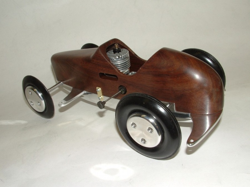

Post  roddie Mon May 19, 2014 10:33 am
Thanks for posting! I saved those scans in my tether-car folder. I've never had a tether-car.. but have been marveling at some I've seen photos of lately. These are "Beast" models.
Thimble Drome Champion - Page 3 Beast_11
This one has a TEE Dee .010!!
Thimble Drome Champion - Page 3 Beast_12

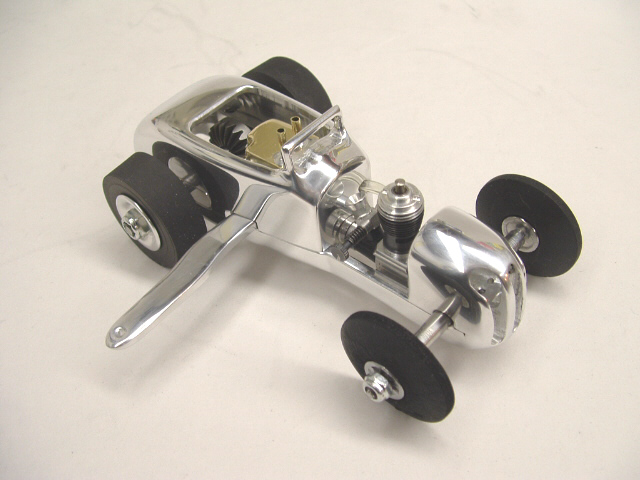

Post  crankbndr Mon May 19, 2014 8:45 pm
Yes, that Beast fellow is quite the craftsman in both wood and metal and if you buy his car you get a free t shirt.
That wood body job in your photo is the only one I have seen that is not powered by Cox.

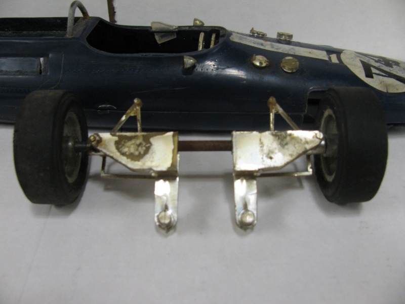

Post  crankbndr Wed Jun 11, 2014 8:30 am
One of the problems I have is refinishing the front axle carriers, they are chromed plastic.
They can be chromed here http://www.chrometechusa.com/model-cars-and-collectibles.html
I would be happy if they were painted silver, anyone ever work with painting old plastic, removing the old chrome, priming and paint?

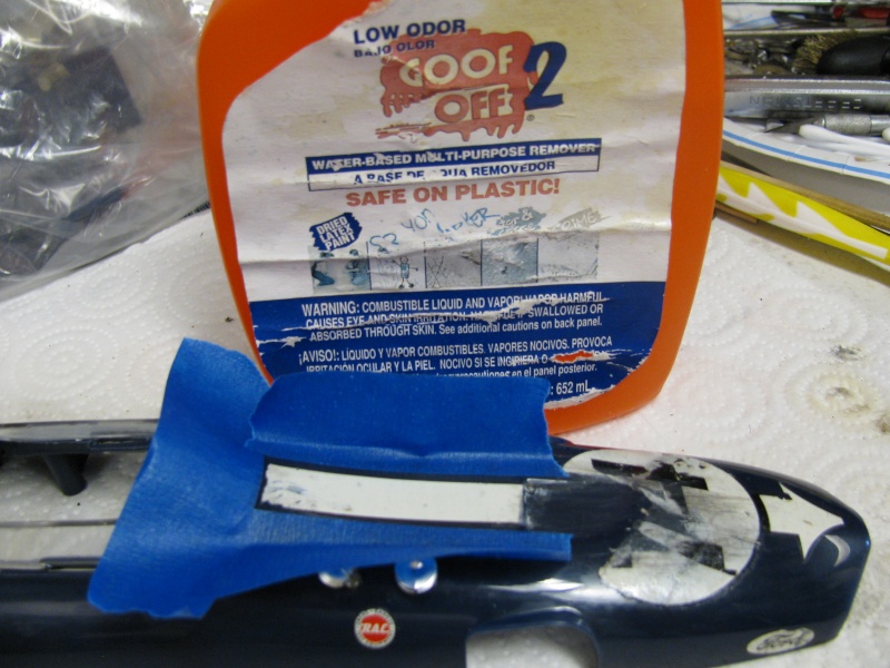

Post  crankbndr Sat Jun 14, 2014 7:55 am
I needed to remove the old decals from the body of the Eagle so thought I would give this stuff a try.
It worked great, fast and left the plastic clean and shiny. Used it to clean the whole body.
Ready for the new 1/12 scale decals I found here,
http://members.optusnet.com.au/pattosplace/home.html

Thanks, I'm glad I tried the Goof Off on the plastic, it works great. Will use it on all my Cox plastics from now on.

Post  Cribbs74 Sat Jun 14, 2014 10:34 am
I have had good luck in the past with painting over the chrome. It's near impossible to remove without destroying the plastic. So I would light sand the chrome to give the paint something to cling to.
I am not sure what you intend to do with the model, but if you put it on the shelf the paint will last indefinitely. If you run the car it may wear off over time.
