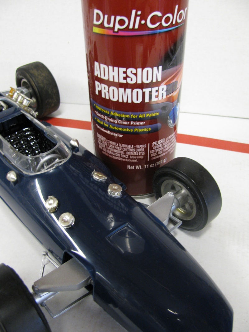

To paint the front axle holders I tried Dupli-color adhesion promoter for plastic and it worked very well right over the chrome.
First the adhesion promoter then light primer coat then color then clear, they came out nice. Not fuel proof though. I also used it to paint the seat black.
I also found a like new set of front wheels and tires.
