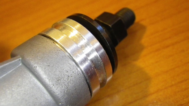

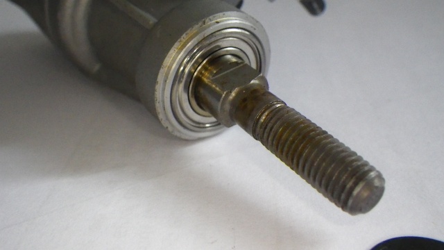

Just one more remark about the OS 25 FSR while we're at it. Following Ken's point of view which is fully understandable, I had a closer look at the prop end in order to check this ball bearing configuration. To have peace of mind and for information to you, Rusty and everybody else, I took all washers and drive hub of the shaft. The bearing is not just an open ball bearing but a double Z type and thus shielded however not sealed. An intermediate washer is located between the drive hub and the bearing. The drive hub has a shoulder that sits over the machined edge of the engine casting with a very small clearance only. A well engineered part and now we know why. Unless you ditch a plane in a puddle, I think this ball bearing is well protected.
Lieven

That looks a lot like the front end of my Thunder Tiger. I'll double check. Good to know, thanks, Overlord. I'm an engine guy and like to know things I hadn't thought of. This would be an equally good design for a bushed engine as well. I've lost front bushings in Coxes because they weren't well isolated from the elements.
- Posts : 10869
Re: Planning ahead again... what engine for a Yak-9
It's fairly common construction in most bearing engines. You'll get a little bit of a shield from the thrust plate. Rear bearings on most of these engines are open. Front bearings may have the rear shield missing or may have both shields in place, but normally are not sealed since they need to allow lube to pass thru.
