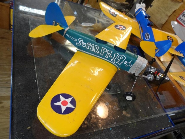

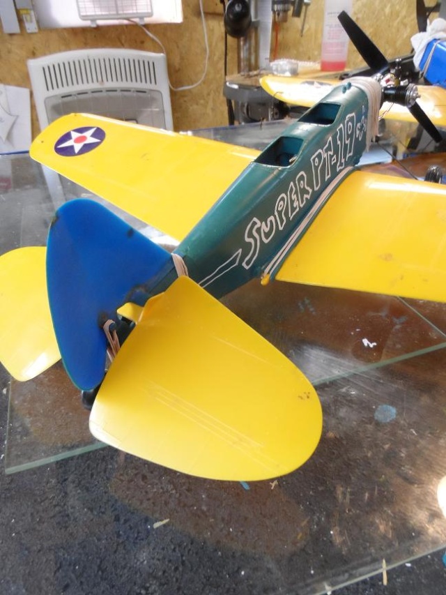

Post  Kim Sun Apr 07, 2013 11:27 am
Hide the Children!!! Load the Guns! Steel Yourself for the Unthinkable !!!!
Yes, it's every RTF's Nightmare! It Scoffs at the Shelf-Sitters...it Snarls a Wicked Grin at those who DARE to call themselves "Flyers"...it's the Leather-Jacketed Hoodlum that you pray your plastic babies will never emulate !!!
The ONLY good thing is: It probably WON'T show up at a flying circle near you any time soon !!!!!!!!!!!
Super PT-19 !!  IT FLYS !!!!!  (or, "How I Test the Tensile Strength of Spider Wire !!) 1_20
Super PT-19 !!  IT FLYS !!!!!  (or, "How I Test the Tensile Strength of Spider Wire !!) 2_21
Super PT-19 !!  IT FLYS !!!!!  (or, "How I Test the Tensile Strength of Spider Wire !!) 2_218
Super PT-19 !!  IT FLYS !!!!!  (or, "How I Test the Tensile Strength of Spider Wire !!) 3_18
Super PT-19 !!  IT FLYS !!!!!  (or, "How I Test the Tensile Strength of Spider Wire !!) 4_14
Super PT-19 !!  IT FLYS !!!!!  (or, "How I Test the Tensile Strength of Spider Wire !!) 5_14
Super PT-19 !!  IT FLYS !!!!!  (or, "How I Test the Tensile Strength of Spider Wire !!) 6_15
and now....More Coffee !!!!!

Post  Mark Boesen Sun Apr 07, 2013 10:17 pm
YEAH!!!!!!!! Very cool Kim!
A thought: You might redrill a new push rod hole in elevator horn for more throw, as well as bellcrank. I did this several years ago on a old pt-19 in an attempt at inverted flight and/or outside loops, but of course i never got to it. I had planned to use a Black Widow, no pilots, 38' 8-10# Spiderwire.
Kim, I think you should be the first one to attempt this historic endeavor, adding the Tee Dee...it's a sign, go for it!
Also, years ago I remember reading a magazine article where a guy actually cut flaps in a pt-19 wing and used Goldberg 1/2a nylon horns. I always thought that would be cool!

Yep...certainly don't count anything out! Several years ago I tried (and may again) increasing the elevator throw to get the PT to crank around harder, but it bled so much speed on the pulls that it'd stall/hammerhead into the circle. 'Course, I wasn't going for inverted flight---just tighter loops, and if I'd employed a bit more finesse, things might have worked out differently...
Yeah Gus, I still love these things, and am totally shameless about flying them in front of my friends' most advanced circle-turners or R/C stuff !!
I've got one of Bernie's throttled engines slated for the other PT fuse...figure to make myself a little imitation J Roberts bellcrank out of ply, and try my hand at some more "Civilized" touch & goes than the full-throttle "Smack and Run" types!

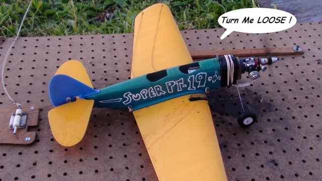

Got the Super PT-19 out on some strings today! I had to wait 'till almost dark for the wind to back off, but got in a several flights as the light faded.
The Tee Dee .51 is the same ole reliable engine that's been dragging my Bird of Time sailplane around for eight years or so. It's REALLY broken in, and starts up pretty easily on the fresh Sig 25% I feed it.
Super PT-19 !!  IT FLYS !!!!!  (or, "How I Test the Tensile Strength of Spider Wire !!) 4_13
The PT's performance might be described by my British Brethren as "Somewhat Spritely", and I've never had an RTF haul out on the lines with such tension. The plane IS decidedly nose heavy, so it will be getting a little butt ballast before the next flights, along with the somewhat lighter stock PT-19 landing gear.
Then...we'll start probing the envelope !!!!!

Cool!
Boy that plane has seen some use. You are going to have to get video although the pictures were nice! You think it will do more than one originally configured? Or will it do the same thing, but just at lightning speed? Very Happy

Yeah, this one was HAS had hard life, and it's torture continues! I want to try it on 40 ft of spiderwire, and figure, with a little more aft CG, it ought to do some reasonable loops and wingovers. With their broad wing, the PT's are some of the better flying RTF's of the single-surface fleet, and I've been able to coax loops out of them with a good .049 up front.
Whether or not the .051's extra power will allow inverted flight or outside loops remains to be seen, but it IS great to have a Cox PT-19 blast into the sky with such authority!
I'll have video of the next outing...I was quickly losing my light yesterday...as so didn't have time to set it up better.
AND I will be putting pilots on board !!!
