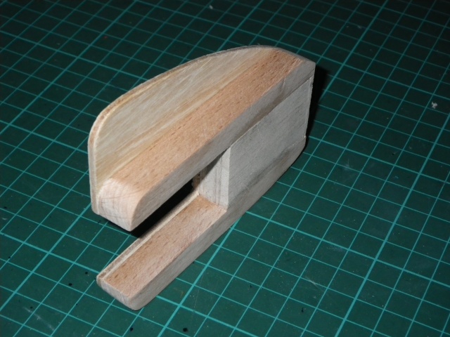

Ken Cook wrote: I would like to make a suggestion here. This would be in regards to the space directly in between the two center ribs. It may be 1/2" or 3/8". Somewhat difficult to tell from the picture. This type of construction is similar to the Shoestring and other planes. When wings are built like this on profiles, I feel this practice leads to the dreaded vibration problems that some experience with the engine run. At this stage, I would choose some lightweight balsa and make a rib with the grain running vertically.This can be done by gluing 2-3 pieces together and slipping it in between and into that center bay. Draw around the rib using the kit rib as a template. Remove and cut to the line and sand. Install and glue and that rib will insure a very strong foundation for the sheeting which in turn has the fuse glued to it. Ken
Talking about the grain running vertically, an intermediate piece made out of "balsa plywood" would give additional strength indeed. On the Jr Satan, I constructed the block that is glued between both engine bearers out of 4 sheets of 3mm balsa glued cross wise to end up with a sort of 4 ply. It was then wedged into this 12mm opening between the centre ribs. It does not cover the whole rib area though. It ends at about 1/3 in way of the bell crank mount. Then again, the 4 centre ribs are thicker then the other ones.
Super Clown build thread (Maiden Report) - Page 2 Imgp1410
Super Clown build thread (Maiden Report) - Page 2 Imgp1810
