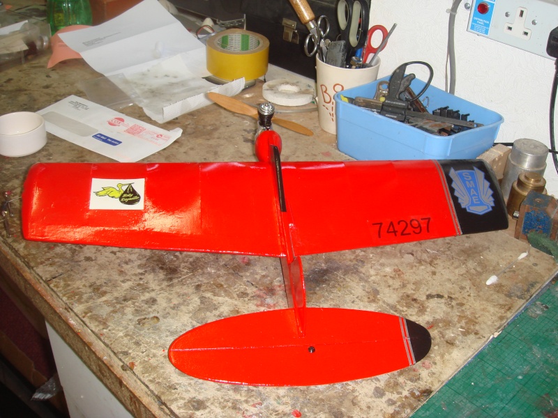

Just to say my Baby Ringmaster is finnished and ready to go. Here's a couple of pics. All up weight 5.6 ozs. I hope thats not to heavy. I seem to have in my head 4.5 oz as a target weight I'm not sure. I know I've aready asked, but would you give it a tad of sidethrust? I do like to see the thrustline pointing out of the circle. I will let you know when I've done my first loop.
Cheers Baby Ringmaster on the loose. 3918962684 Baby Ringmaster on the loose. 4201307885

The Cox reed 049 puts out about 6 oz of thrust (Many many variables, your results may vary). You should be in great shape with greater than 1:1 thrust to weight ratio.
Handsomely done!

Nice plane, and the weight sounds fine. Yes, a couple of degrees of side thrust will keep you from running away from the plane.

+1 about 2degrees should do it. Nice job on the build. I like the way you filled in the nose.

Thanks guys appreciated. I only filled the nose like that because I've never seen one, and I couldn't work out the nose from the CAD plan I have.

These thrust wedges work well and don't distort the wood like washers do.

Thanks for showing me the thrust wedges, what a great idea. It will be great to be able to quantify thrust angle. Rather than washer thickness.

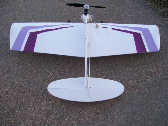

UH-OH, I have a pair of Baby Ring Masters, too! (is this hijacking a thread?)
So, I need an airplane to get me inverted, on purpose, and this is one suggested by Ron, I think. Hopefully, I won't have to glue it back together as much as he says I might have to!
They are built from plans, and I cut all the parts, first. One is for my Brother, and the purple and white one is mine. I built a tank to fit in the wing, because I didn't have one that fit well behind/beside the SureStart engines. Then, I forgot to install it in the wing, before it was covered, with Ultracoat. The fuselage is painted with Coverite's spray can paint. I opted to use a traditional Sterling-type elevator control horn on them, just for conformity to the RingMaster authentic look. It's ready to go, and weighs 5-3/4 ounces on my old, old old postal scale. 33 foot SpiderWire lines will be used for control. Wish us luck! Thanks, GusBaby Ringmaster on the loose. 100_1110Baby Ringmaster on the loose. 100_1111Baby Ringmaster on the loose. 100_1112Baby Ringmaster on the loose. 100_1113

Ah, Rusty...Good call on the outboard tank issue! It did cross my mind, but I had not thought of solving it the manner you suggest. The pick-up tube is standard 1/8" brass, but the vents are smaller. So, VRRROOOM on the rpm if there's a problem. Okay. I am able to shorten the fuel line a little, and I could use slightly larger diameter, also. That little, whitish stuff IS snug on the fuel nipple! Do you think that could help too, if I run into problems? How far out of kilter could I place a tank on this, and still get it to run well? Would above the wing, on the fuselage side be too far from centerline to get a good run? The planes I "design" are allowed-for in the nose area, for the engine and tank to be positioned conventionally. What about stretching the nose to allow for a decent-size tank? Throw the CG off too much? Geez, what a rookie!
I just REALLY need to get some reliable "stick time" to get comfortable with unusual attitude flying! This is a step in that direction.

The reason I switched all of my 1/2As to pressure bladders is I threw up my hands early and gave up on getting wedge tanks to work. I can only reliably tell you what didn't work.
Ken cook and Fit90 are the ones I can think of right off the top that have mastered wedge tanks. Ron's seem to work. I have yet to ever successfully run a wedge tank. I have had good luck with unpressurized party balloons on engines that I didn't have the fine thread NVA needed for pressure.
Fly your plane and see what it does. It might work fine as long as I don't touch it. Rolling Eyes

I thought too, about locating the tank on the inboard side of the fuselage, but the lead-outs are right there. I'm waiting to finish my brother's, to see how mine works, because I don't want to give him a dud. Maybe stretch the nose just a bit, to get a tank in there? I'll fly it, and see what happens, when the wind stops howling. Temperature was in the 80s, today and yesterday. Last week, it was snow and ice. Kansas!

So... I thought that before the weather took a nose-dive, I'd take the Baby RingMaster out for one. Ha Ha! Wind was at least 10 mph, gusting to 20. It was going to be interesting. Set-up BRM, run-out lines, (33 ft. SpiderWire) , stooge in place, fueled and started, be-bop out to the handle, Pull Cord! Great ROG, decent power and climb, but when the plane gets to the upwind side of the circle, it turns in, and flies straight and level across the interior of the circle- from the 90 degree point, to the 270 degree point. Of course, I was back-pedalling swiftly, to maintain line tension, and managed to regain control at the start of the downwind leg, when the wind snapped it back to normal flight. I flew the downwind 1/2 of the circle, with no funny business, but the 2nd lap was the same as the first. Then the 2nd downwind snapped right into place. So... I have invented a new maneuver... I call it "D PLANE,D PLANE" because as viewed from above, it looks like a capital "D" lying on it's side! Now, you will frequently hear little people shouting - D PLANE, D PLANE, and that's just their request to have you perform the new maneuver, again.
