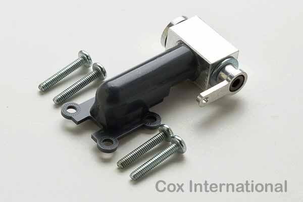

throttle unit
Wanted the muffler from this
and some new silicone fuel line!
anyhow I am waiting on these parts to get to work on it again and hopefully mod it to work and get it completed.
throttle unit
