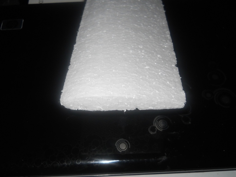

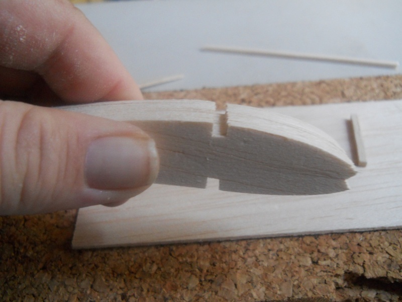

I have the foam core cut and ready for sanding, leading & trailing edges and sheeting.

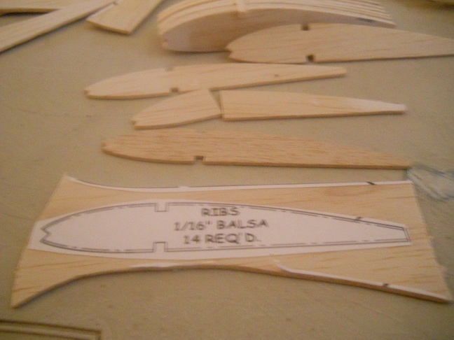

I cut and sanded the balsa ribs and the stab & elevator out yesterday evening. Only took about 45 minutes for the ribs and about 5 minutes for the stab.

 La Stick Scratch Build for Cox Pee Wee .020 Foamco10
 La Stick Scratch Build for Cox Pee Wee .020 Ribcut10
 La Stick Scratch Build for Cox Pee Wee .020 Ribcut11

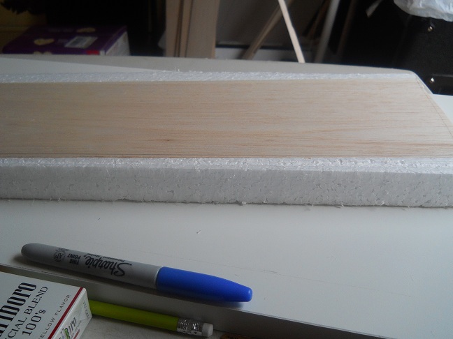

Okay back to the build. I got some 1/32 sheeting for the foam wing core and will try and get that shucked up tonight, I have the fuse on the building table as I type and will start gluing it up here in a bit.

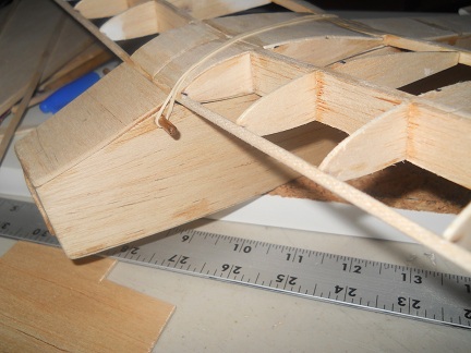

The fuse is now complete with servo rails installed, an engine spacer glued on and final sanded and ready for covering. Now it's on to the wings. I got the foam core skinned and drying in the shucks. This is the first foam wing I ever made using a hot wire bow and my first time sheeting a foam wing. I hope it turns out good. So I ask that everyone keeps their fingers crossed! After I finish up the that wing, I'll start building the balsa wing. I was hoping to have the plane done in time to take with me on vacation but it's gonna have to wait until I get back.

 La Stick Scratch Build for Cox Pee Wee .020 Fw110
 La Stick Scratch Build for Cox Pee Wee .020 Fw210
 La Stick Scratch Build for Cox Pee Wee .020 Fw310
 La Stick Scratch Build for Cox Pee Wee .020 Fw410

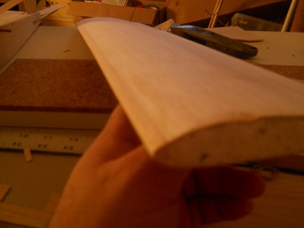

I went out to my shop and pulled the wing from the shucks and it turned out GREAT!! It turned out strong and feels very light. I don't have a scale so I am only going by feel but I think it will fly just fine. I still have a little sanding to do for the leading edge cap which I will do here in a little bit and will post more pics.
Shawn
 La Stick Scratch Build for Cox Pee Wee .020 Wing10

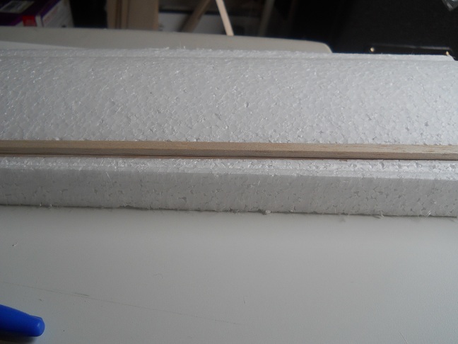

I got in quite a bit of time out in my shop today and was able to get quite a bit done. I glued the leading edge cap on the foam wing, trimmed and sanded it so all that is left is the trailing edge, wing tips, ailerons and mount the aileron servo. So far the foam wing is turning out really good. I also built the balsa wing and got it finished. I just need to fill a couple low spots in the center section sheeting with some micro-lite filler, give it a final sand and it'll be ready to cover. I'm pretty much at a stopping point right now as I needed to order some linkage pieces for the ailerons, some covering and some micro control horns. Here are a few pics of my progress. I wanted to take more pics but the batteries in my camera died. I'll finish the build when I get back from vacation. I'll be back in 8 days.
Until then, Happy Landings.
Shawn
 La Stick Scratch Build for Cox Pee Wee .020 Fwle10
 La Stick Scratch Build for Cox Pee Wee .020 Fwle210
 La Stick Scratch Build for Cox Pee Wee .020 Fwle410
 La Stick Scratch Build for Cox Pee Wee .020 Fwle610
 La Stick Scratch Build for Cox Pee Wee .020 Wb110
 La Stick Scratch Build for Cox Pee Wee .020 Wb210
 La Stick Scratch Build for Cox Pee Wee .020 Wb410

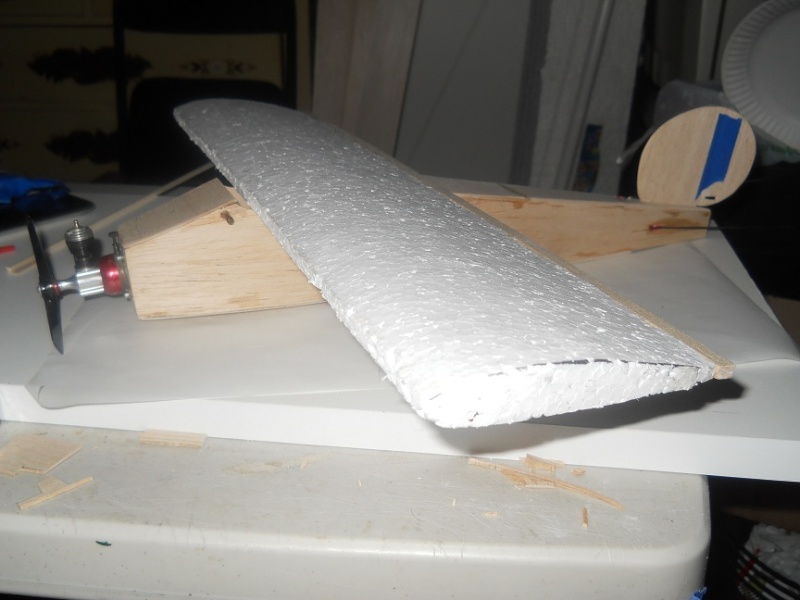

I couldn't just let my plane sit out in the shop all alone so I did some sanding and I think I sanded way too much. Sad
 La Stick Scratch Build for Cox Pee Wee .020 Stick10

Post  sdjjadk Sun Jun 09, 2013 10:10 am
I did however make the cutout for the aileron servo in the foam wing. It was pretty simple to do. I cut the bottom sheeting at the thickest part of the airfoil and I heated a piece of wire to melt the foam and traced around the cut out. I made the cut out a little bigger than the servo case so I could box it in with some 1/32 balsa for added strength. Once the glue dries, I'll trim it up and add the mounting rails. For all of the foam wing construction, I'm using Gorilla wood glue and I'm really liking it. I normally use Tite-Bond but decided to try the Gorilla glue as it was on sale. It's excellent stuff. It dries fast and sands easily.
Shawn
