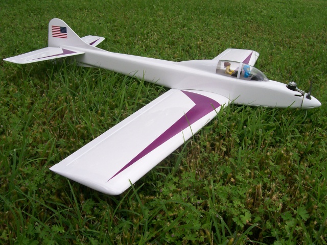

Here is the lastest completed model from the shop:
It's a built-from-plans Sure-Flite Baby Birdie. Power is a COX TD .049 with a fine thread needle and a pressure backplate. Right now, it has the COX 6x3 gray prop on it, but that may change after a flight. The plane has a tapered ACE foam wing, and the fuselage is balsa. Everything is covered in Ultracoat. Aileron and elevator function, only. The wing is held in place with nylon bolts, rather than rubberbands. Before radio installation, the airframe weighs 14.7 ounces. I'll use two JR DS188 servos, a Spektrum AR400 RX, a COX 2S, 7.4V, 250mAh LiPo battery for the controls.
This plane is not slated to be an entry in the Contest, unless I put the .051 on it. This should be pretty zoomie! I will install wingtip skids under the plane, to allow landing on the runway, to avoid yoinking the wing bolts on the grass. It should skid in quite nicely, then, without marring the underside of the plane. Flying should begin this weekend with this one.

That looks really nice. How do you fill the tank? I could only see the pipe to the engine.
I know it must all be sealed.

Oh, you know what? I'm gonna have to add a third line in there, to vent when filling, and cap it when done! Ha! Can't fill into the crankcase! Good call! (my first pressured COX) I'll get it. You just saved me a problem at the field, although, I usually run the engines in the driveway, after completing a model. This one, I've only run on the test stand, and had full access to the engine, so filling wasn't a problem. You got me!
