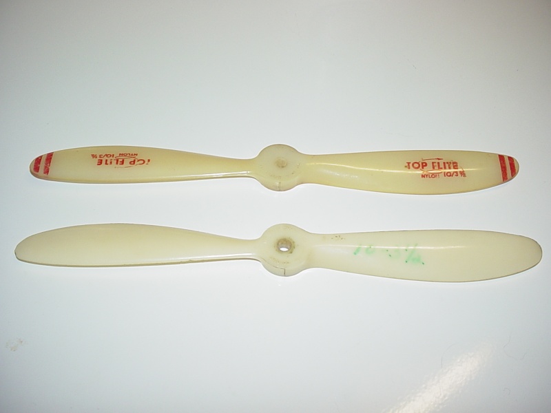

Rusty... I have x2 old Top-Flight 10 x 3.5 nylon props in my stock. I will mail them both to you if you'd like. I'd feel lousy; knowing I had a prop that you couldn't find... to help you compete. Let me know if you want them.
Roger
Roger

Thanks, Roger. PM sent.

Hey Rusty, Here's an ebay link to some NOS Top-Flight "WOOD" 10 x 3.5's... a whole box of 12 for $10.00 as of this posting.
edit: Like Mark B. stated; the wood props might be worth it, going forward. If this size works out... you'd have plenty to practice with, before competition time.
http://www.ebay.com/itm/LOT-9-new-Top-Flite-Propellers-store-package-NOS-10-3-1-2-size-/181220825729?pt=Radio_Control_Parts_Accessories&hash=item2a319a5a81

Hi Mark. She likes to run away with the woodys more than the plastic props, but I do have a couple in my box that I have yet to try. With the TF Power Point 10x4 I set it so slobbery my pit man had to pinch the line until I took off and then it leaned out again full speed. Roddie sent me a couple of nylon TF 10x3.5s and I'll try those this Saturday. I'll be surrounded by "experts" for the first time ever that day at a fun-fly in NC. What I know about changing diameter and pitch in 1/2A doesn't always follow with the big plane.Mark Boesen wrote:If you can find wood props you might lean toward them, safer, easier to balance and easier to trim down. Remember pitch is an average of that prop and if you cut it down the pitch goes up.

Thanks, Roddie, it's in my watch list. I may let it go considering my past experiences with woodys though. I do have hope for those Nylon 10x3.5s you sent me, even if I cut them to 9". See, that's one example of how this is different from 1/2A. I would never expect to slow a plane down by cutting the prop. That's what happened when I went back down to 9" and it made for much better flying without leaning out or bogging. Maybe 10 is too much for the TT. The literature on this engine says 9x4 and 9x5 is the recommended prop, but that's also for its intended RC use.roddie wrote:Hey Rusty, Here's an ebay link to some NOS Top-Flight "WOOD" 10 x 3.5's... a whole box of 12 for $10.00 as of this posting.

Thanks, Jacob. Lets see what happens with what I do next. If I need to take you up on the offer, they'll probably still have them.Admin wrote:I can run up to Hub Hobby to see if they have any 9x3 props. You know, its basically a straight shot up the road from me.
