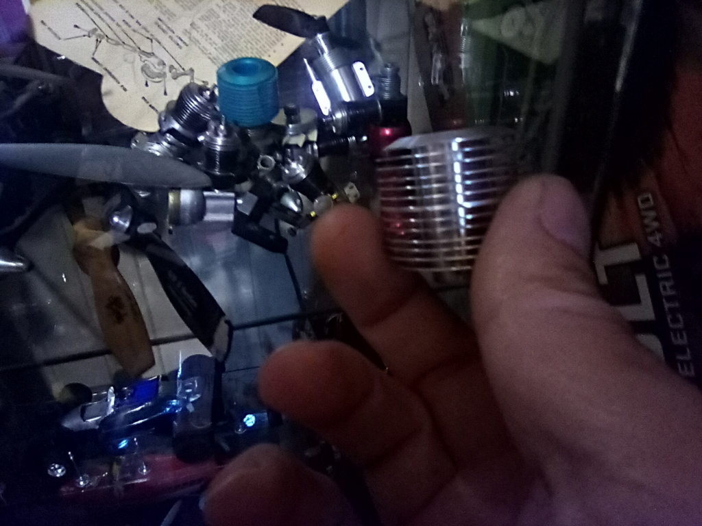

The best for Cooling and glow plug is the norvel heli heatsink head Cox Stocker 0.49 / Indy Car / Nissan GTP - Page 3 Img_2306
Cox Stocker 0.49 / Indy Car / Nissan GTP - Page 3 Img_2307
Wit the normal Cox heatsink its possible To enlarge To fit over its cylinder and use a biger glow plug like the one on texaco or the big heli one

For the heatsink cooling head there are two models one made on the standard glow plug the other with a typical raising part of the Cox gtp is different made only on the glow plug designed for this purposeCox Stocker 0.49 / Indy Car / Nissan GTP - Page 3 Img_2309
Cox Stocker 0.49 / Indy Car / Nissan GTP - Page 3 Img_2308
This is m'y création stack two heatsink on m'y engine the old cox one fit on the cylinder and the new desing norvel type Heli head heatsink Cox Stocker 0.49 / Indy Car / Nissan GTP - Page 3 16494710

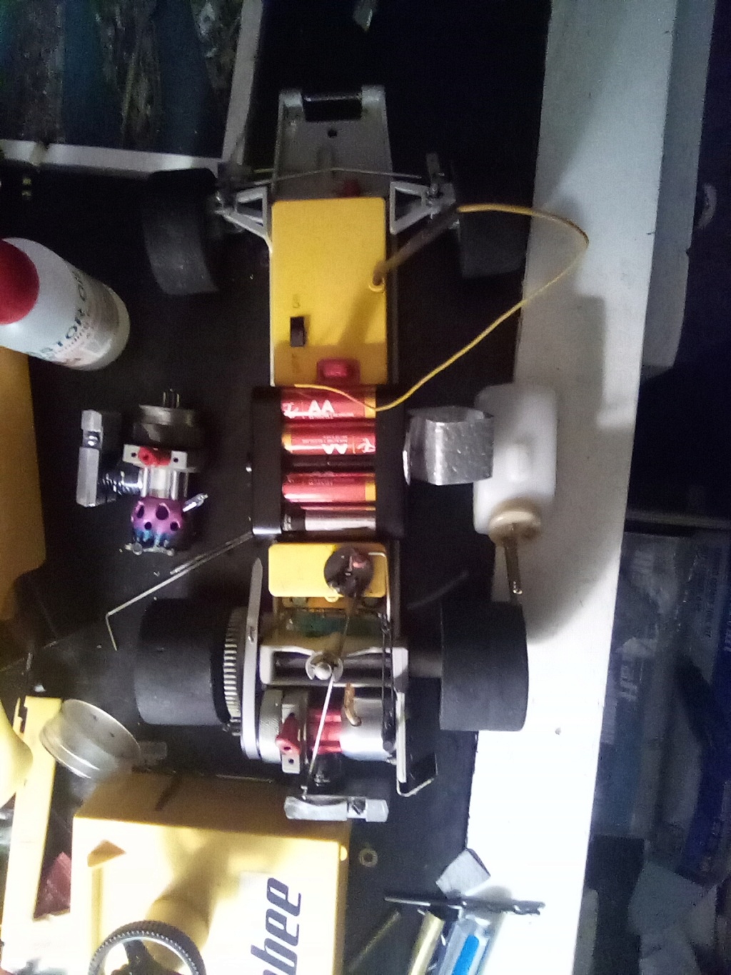

And dont ever never run a cars engine without its heatsink Unless you drive very rich, not long less than a minute Even with the heatsink it can overheat if it is runing too lean use castor oil as possible for cars its very important i like To run the gtp its a fast one drive Good To stil a bit bumpy But it's typical of this chassie much less worse than the jerobee that wheely and so mutch faster wit the tee dee engine Cox Stocker 0.49 / Indy Car / Nissan GTP - Page 3 Img_2313Cox Stocker 0.49 / Indy Car / Nissan GTP - Page 3 Img_2315
