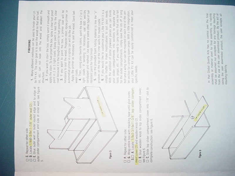

Post  roddie Mon Oct 14, 2013 1:29 pm
This is a nice little field box. I have one... it's buried in a closet, or I'd provide a pic. I "do" however have the original box/instructions handy. Panels are all of Mahogany plywood, which I chose to leave natural... sealing it with clear polyurethane. I also padded the cradle with 3/8"W. foam weather-strip tape... instead of what's shown.
EDIT: I searched the web, and couldn't find it anywhere. I bought it on sale for $9.95 back in 1993 at a local "Hobby Town"

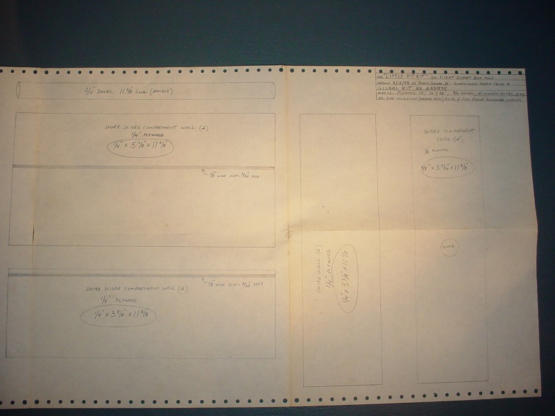

That would be perfect Roddie. Is it big enough for .19-.35 sized items?
I see you highlighted the dimensions, but I am having a little trouble making them out. Thank you very much for posting that!

Post  roddie Mon Oct 14, 2013 4:55 pm
any better? I could scan the pages later on if needed. This is a small flight caddy... approx. 12" x 12" square. As it states on the box; "Absolutely Perfect for 1/2A-.15 size models"... I guess it depends on what you usually take to the field, as for whether it would support your larger planes. Qt. sz. fuel bottles are the largest that will fit. The side bins with the sliding covers will hold lots of props... and up to 11" dia. They're shallow "enough" not to have to "dig" to find things... which can be good.

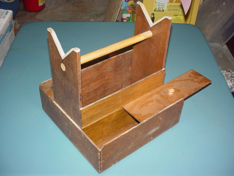

Hey Ron, no worries... glad to help. Here's an idea to try, without having to change dimensions. Cut another pc. of 1/4" plywood 5" x  24" and screw it to the bottom of the base. This will give you a 6" extended "floor/shelf" on either side. Pick a side for your gal. fuel jug and use bungees/hooks or lg. sz. (6-8") hose clamps to secure it. The other side's 5" x 6" floor-extension could be counterweighted by making a battery box... or a "bin" to hold your heavier items. The full-length dowel carry-handle will help with balancing too. You may want to brace the side "uprights" above the dowel holes, for the extra weight.
Just make sure that whatever you propose, doesn't "interfere" with the slide-covers opening. A 1 gal. jug probably "will"... on whichever side you choose to mount it.
I dug mine out of the closet...
Field Box plans Lil_pi16
Here's a perspective with a round 1 gal. jug...
Field Box plans Lil_pi17
Note: The slide-cover "knobs" are glued-on. Any method of attaching them with a screw would require "notching-out" the end panels of the bins (top/center) for clearance to install the covers... My knobs are drilled and "pinned" into the cover "flush" on the bottom side with sm. dowels. Alternately,you could drill a "finger-hole" in the cover to slide it open/closed.
If I were to "scratch-build" this box... I would "hinge" the bin covers... it's less complicated, and you would have the freedom of expansion without concern for their sliding clearances.

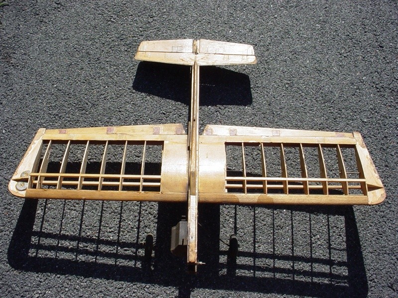

Post  roddie Tue Oct 15, 2013 9:54 pm
Cribbs74 wrote:Glad you found those parts! What does that no name plane look like?
It's an old "built from plans" .19-.35 engine-sized stunter... unique; in that it is a "built-up" profile fuse w/push-rod running inside. I was told by my Uncle (who built it) that it was called a "Topper"... but I've searched several O.T.S. plan archives, and haven't found anything by that name. I located a Warrior "fin" this evening, while re-uniting the "new-found" parts with another parts box. The Warrior fin/rudder looks like it could be "faired-in" to this model and look o.k.... What do you think?
The "Topper"?
Field Box plans Topper10
The "new-found" Jr. Flight Streak tail-feathers and Warrior fin/rudder

Absolutely Ron! I really want to know more about this model. Who designed it... what magazine it was featured in... reviews... My Uncle can't remember... and the plans are likely long gone. There had to have been a full-size plan for it available at one time, that he used to build it. Any help with info. would be greatly appreciated!
Here's 3 more pics... Note the odd fuse-protrusion/block at the r/h wing t/e...?
