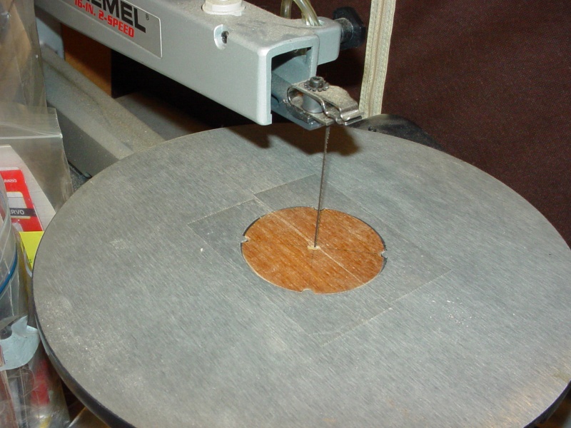

Thanks Ken, Yea... I had no experience with Comet kits at the time... and AHM's description was vague in their mailer/flyer catalog... (you remember those?) I now have the scroll-saw (Dremel) that I knew I'd "want"... to allow me to cut those printed pcs. out of their sheets... if I ever do decide to build it. Parts with questionable grain direction/hardness could just be traced and re-cut from a better sheet. I don't mind sanding... It was the thought of "knife-cutting" all those little pieces out "whole"... without breaking any, that kept me from building.Ken Cook wrote: The conversions I've made from rubber to glow never really flew well. I can only contribute that to the fact that the models true intent was free flight therefore it's construction doesn't lend itself to the rigors of glow. They require balsa sheeting from F-1 typically back at least 2 formers and the longerons usually need a bit of beefing as well. Comet kits were all generally print wood sheets. This is far superior to die cut due to it allowing you to make all the pieces the same by stack sanding. The wood however is mismatched at times for it's purpose and therefore when trying to cut a radius the wood wants to split with the grain.
I do know of a fellow who's plane was featured in Model Aviation and was also displayed on the Guillows website. I believe his name was John Reckner. He used a Thunder Tiger .07 for power in a ME-109 due to it's needed weight for the nose. I watched this plane fly and although it wasn't very aerobatic, it was truly a beautiful looking plane. He used many of the kit parts but cut Dow board blue foam for leading edge for many of the intricate parts that wouldn't allow the balsa to curve properly. Water based model paints were used in a airbrush and this plane looked great in the camo scheme. Ken
I made a plywood table-insert with a small hole for cutting small thin pieces. It works really well.
