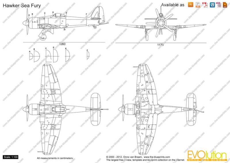

Hey Duke... How about a Hawker Sea Fury? Plenty of racing heritage there!
CEF speed contest Design Discussions Hawker10
