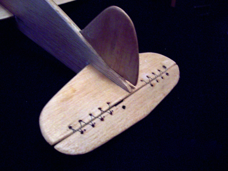

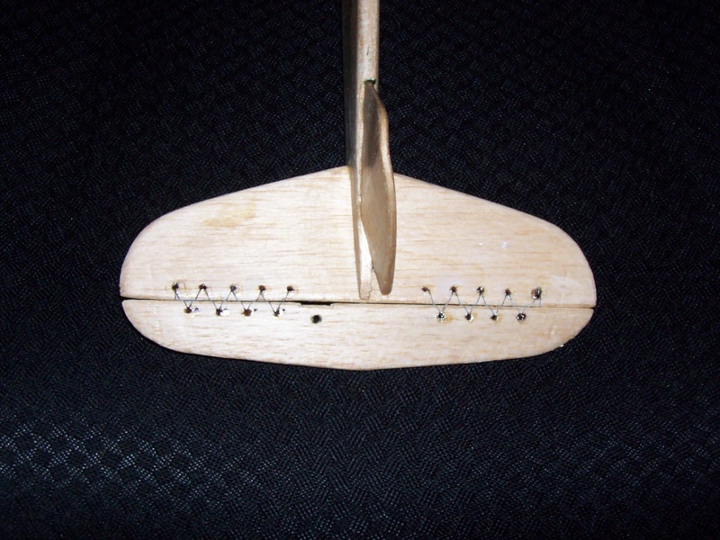

Post  Oldenginerod Sun Jun 01, 2014 2:21 am
Here's a few pictures of my first stiching effort, along with progress on The Cadet.  The holes are a little big as that's the smallest drill bit I had.  They look bigger in the pictures than they really are due to the blob of C/A I put on each.
The Cadet 1/2A model 100_4010
The Cadet 1/2A model 100_4110
You will notice some dots on the left side.  Just a little mistake on marking it out and are not actually holes.
The Cadet 1/2A model 100_4111
Required holes are drilled, surface filled with talc/dope filler and almost ready to do a final sand and paint.  Then to choose an engine.  Maybe a Golden Bee? Huh...
Rod.

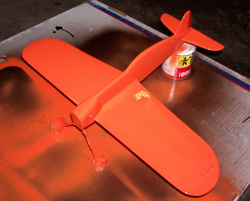

Post  Oldenginerod Tue Aug 04, 2015 4:30 am
Well, it's been a while, but I have made a little progress on the Cadet.  Finishing is what has held me up.  There are so many different opinions about paint choice that it's really confusing.  I brushed on and sanded about 3 coats of dope and then sprayed another coat of dope tinted with automotive tinter.  I asked the tech guy at the paint company and he assured me that Acrylic Lacquer (widely used here) tinters were compatible with Nitrate dope, so I got my local guy to mix up some dope and orange tinter- looked great in the can.
Sprayed it on with a small touch-up gun but it was a little too opaque and dried to a really flat finish.  What to do now Huh... .
I have no hobby shops anywhere near me for paints such as Lustrekote, but I do know that Rustoleum has recently purchased a large Aussie paint company.
Today I had to drive a couple of hours to see a specialist in the city and on the way home passed a Masters store.  I thought, "American hardware store, American paint".  They had a full range of Rustoleum paints, and although some say that they still don't perform well, there are equally as many who say it works just fine, so I grabbed a can and tonight gave it a quick coat.  Really good gloss and covered well.  Just need to give it plenty of time to cure.  Being our coldest winter in 30 years, it may take a while.  Here it is.  Those with a good eye will see a paint drip, but I have fixed that.  It's probably heavy & I have no scales to weigh it, so I guess it doesn't matter.  That reminds me, I forgot to epoxy on a tip weight before painting.  Oh well.
The Cadet 1/2A model 100_4620
The Cadet 1/2A model 100_4621
The Cadet 1/2A model 100_4622
The Cadet 1/2A model 100_4623
(The slow but steady) Rod
