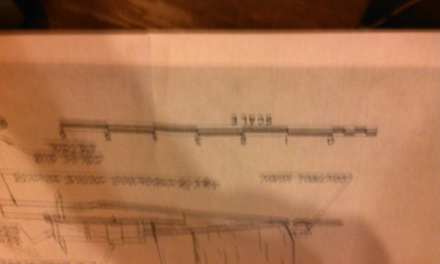

well this is going to sound STUPID so a good laugh u will have on me, look at this 0-6" scale and tell me it don't start at the before  o ?  measurement questions Wp_20170  I was about to start cutting wood and looking at the plans ?? that don't look like 6" being I know about how long as that is lol! DAMMIT!  . I had measured the whole picture Embarassed so I thing I only have a 5"scale drawing. Eric Vaughn Zipper

I think sometimes the drawing shows a  0 to 6inch scale with divisions below the "0" mark to be able to measure 1/4inch increments, ( or whatever the smallest increments shown are), if the maker of the kit needs to measure less than 1inch. Two Cents

I am a little confused Eric, are you saying that you printed too small the first time around?
That first square in that scale is just drafting silliness and should be measured from the 0-6.
Keep in mind even if you re-print just the scale line that everything needs to be increased or decreased to match. I am sure you knew that anyway.

Yeah, some of them have a -1" on the scale axis before the positive (right side) of the scale.  That's why you got a 285% enlargement and I got somewhere over 300% when I scaled the drawings.  Just do the cut and past of the scale again like before, and measure the 0-6" part of the scale and ignore the left-most 1" portion of the scale.

333 % was as close as it would let me get I am good with it, plans cut and taped got wood ready for tomorrow . We got ice and some more snow ill probably be home ! Thanks Mark Very Happy

 Yes Ron , I measured from before the 0 witch made the drawings 1"short plane 13" small...I am at 16"now Thumbs Up could have been 020 size  lol!
