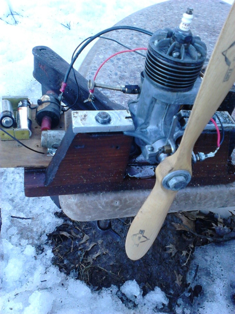

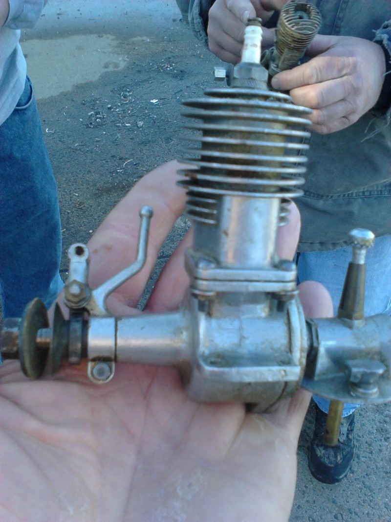

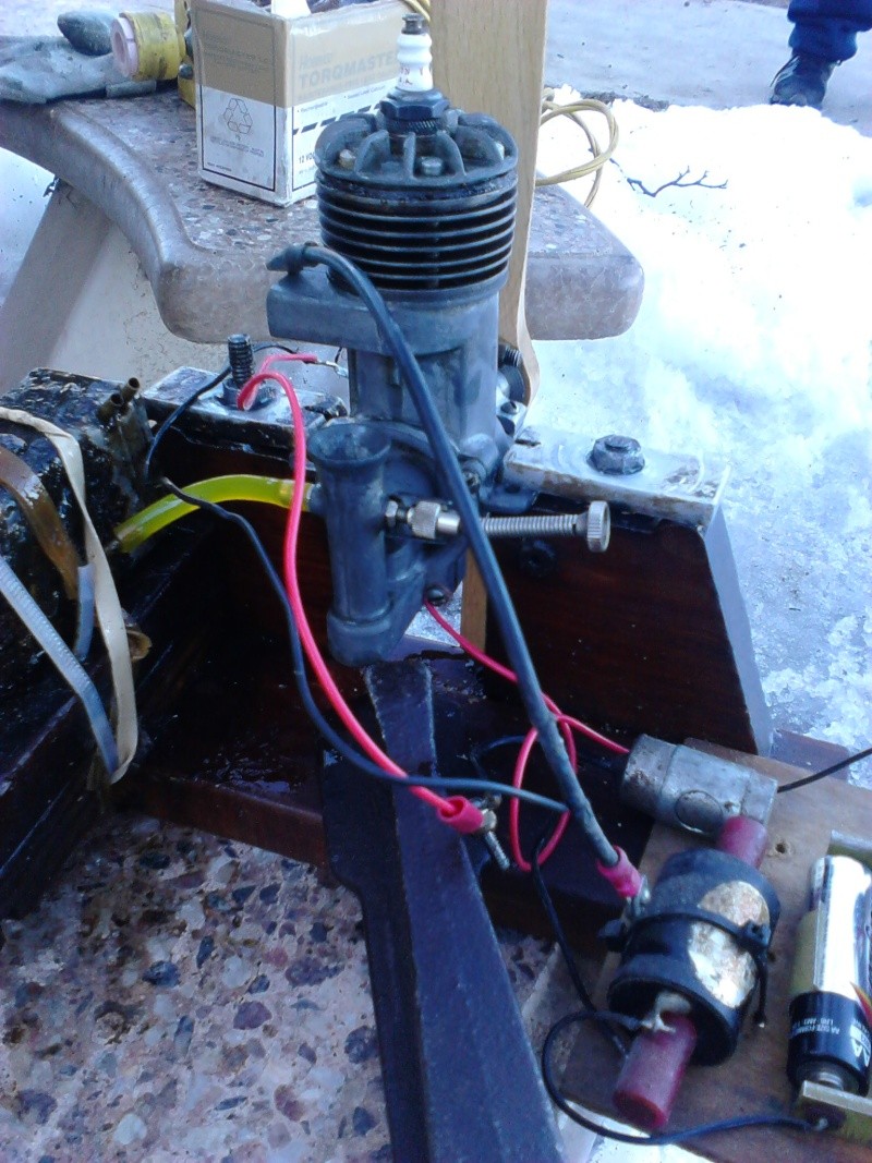

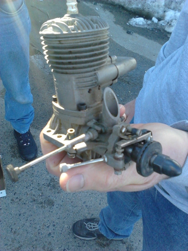

Today was the nicest temperatures we've had for the past 2.5 months. The temps made it into the 50's however the flight gods were just not on our side today. The winds were 20 mph and gusts up to 35. Snow is still heavy on the ground although rapidly melting. We did manage a few flights but the winds caused one of our experienced pilots to lose a plane due to the wind which pancaked the plane while it was inverted. So, we did the next best thing, we shot the bull and ran engines. The old spark ignition engines came out. Anderson Spitfire and Super Cyclones, The Mccoy .49 and a few others. These are strong runners and not to mention LOUD!!!!!!. The Atwood .63 was sounding mean. I received a good crack on the hand reminding me that I do have fingers. Felt like it was going to break it. These engines swing some pretty good size props. While they don't do it fast, they do it with authority. We ran some on gas and castor oil then removed the spark plug and ran them on glow fuel to compare ease of starting and rpm's. Way cool stuff

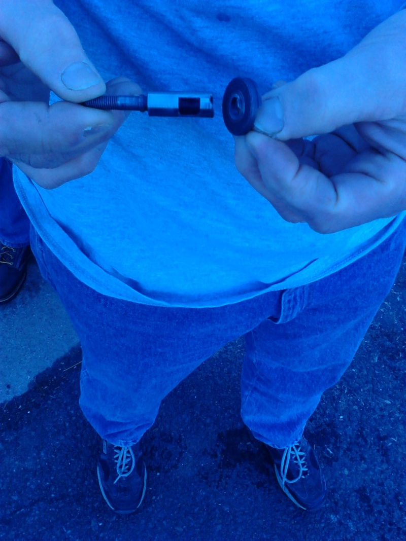

In the last pic was the Fox .35 crankshaft. Just a reminder not to get too attached to that sweet running Fox. This was flight 489 on the Fox .35 which is documented by my friend Dan. Ken

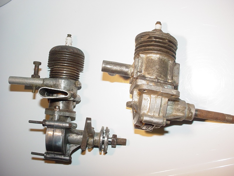

That must have been fun Ken! What blend of fuel do you run in those old spark ignition engines? Gasoline/oil mix I imagine? Ratio? My Uncle just gave me an Ohlsson .60 and a G.H.Q. yesterday... along with his old Veco Renegade combat job!
The engines are missing parts... I know... but he was going to throw them out... along with the airplane.

Nice prop strike mark on the index finger of the right hand holding the busted crank. I've had more than enough of those. I'm now a chicken stick wuss. Did it break just doing a bench run? I'd like to see a sparker run and a diesel too. Never seen either. those spark engines looked big.

Roddie, the fuel bowls and timing advancements are typically missing on a lot of ignition engines. However, your .60 there would run just fine on glow. Put a plug in it and go fire it up. I had a one yesterday running. They do concern me due to the cylinder head being spot welded on. You could blow the top right off. Our fuel was nothing fancy, 1/4 part castor to 3/4 gas. No fancy measuring devices, just poured it in the bottle and gave it the ole good eye. We fly a few spark ignition engines now and then. Very rarely as they just take a lot more patience. We also had the Drone diesel going . I'm fascinated by the technology of yesteryear. I vote you find those needed parts and get those ole turkey's running again. Ken
The Fox though was a bit upsetting when it broke. I'm seeing more and more of this as our engines our getting considerably older. We run them pretty much weekly when we can and this one was almost at flight 500. Typically the Fox .35 breaks at the cutout in the crank across one of the square corners. Mine broke a few weeks ago at the pin. These engines though have lots and lots of flights on them. Good news is, it's already repaired. Ken

Thanks for the advice Ken! Apparently there's a LOT more to getting the Sparkers to run.. I get the concept.. kinda".. but I always thought that all you needed was a battery and coil unit. I watched some vids.. and I seem to see a lot more gadgetry involved.

Woody Bartelt is Aero Electric, he has parts for dozens of spark engines including GHQ, Ohlsson, Dooling.

Ken. you might have addressed this before since I have some memory of the Fox crank failure at the edge of the fuel channel. Has anyone tried rounding the corners to hopefully relieve some of the stress in that area?
