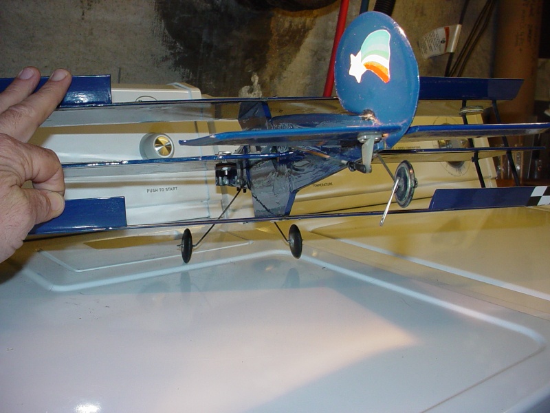

I designed/built this triplane back in 1993. It's a wonder it's still in one piece! It's gone through several moves.. storage units etc. I only flew it once or twice back then, and it has been out in the shed for the last 3 years. It had a Cox .049 prod. engine and wedge-tank. I think I had a lot more patience back then.. probably from having identical triplet Sons born when their Sister was only 1 year and 9 days old!! Got married in 85.. had a daughter May 87 and the three boys May of 88!  Affraid or WOW!

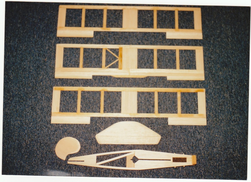

Here's the "bones" back when I was building it.

Kim, This airplane is tail-heavy. The 1st time I flew it.. I almost lost it, and flew 2+ minutes with the model wildly porpoising  Affraid or WOW!...  The second time, I put a Cox "Sandblaster" type heatsink on the glowhead for more nose-weight.

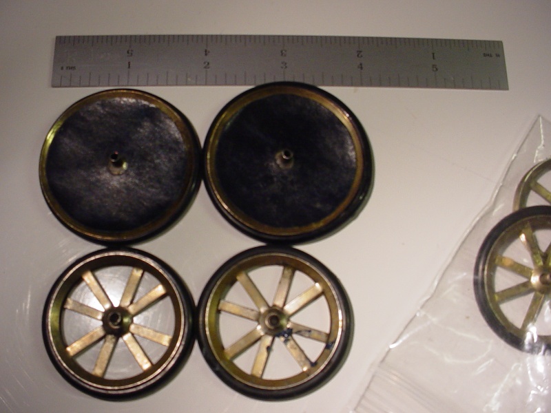

I can't remember if I had flown it yet in the last photo (1993?) where the engine is mounted... but the gear-wheels in that photo weighed next to nothing. I got them at a craft store and wished I had bought more of them.
Dug this plane out of the shed Wheels11
The large pair were on the triplane.. and were the largest of four diff. sizes. I cut and painted cardstock hub caps for them. They were all Tin-sheet spoked.. with a metal tube axle and black plastic tubing tires. The smallest were 3/4".. which is what I used for the tail-wheel.

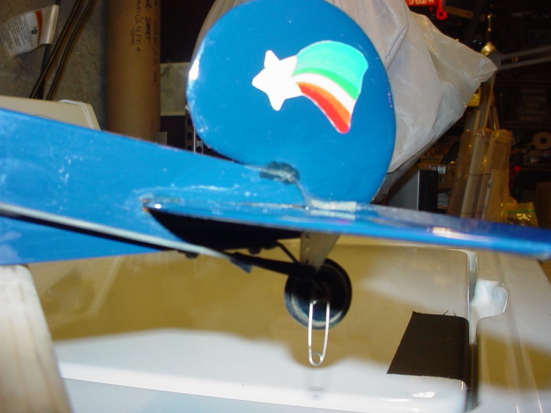

The model now has a pair of HEAVY 1-3/8" dia."Perfect" streamlined wheels on it. I can't remember if I flew it with those on there. The firewall was sized for a horseshoe backplate.. so I may enlarge it with a 1/16" ply plate and put a Golden Bee on it. Either way it's too heavy to try stunts with a reed valve engine... but at least I can move the CG back by doing that and losing the external tank.
