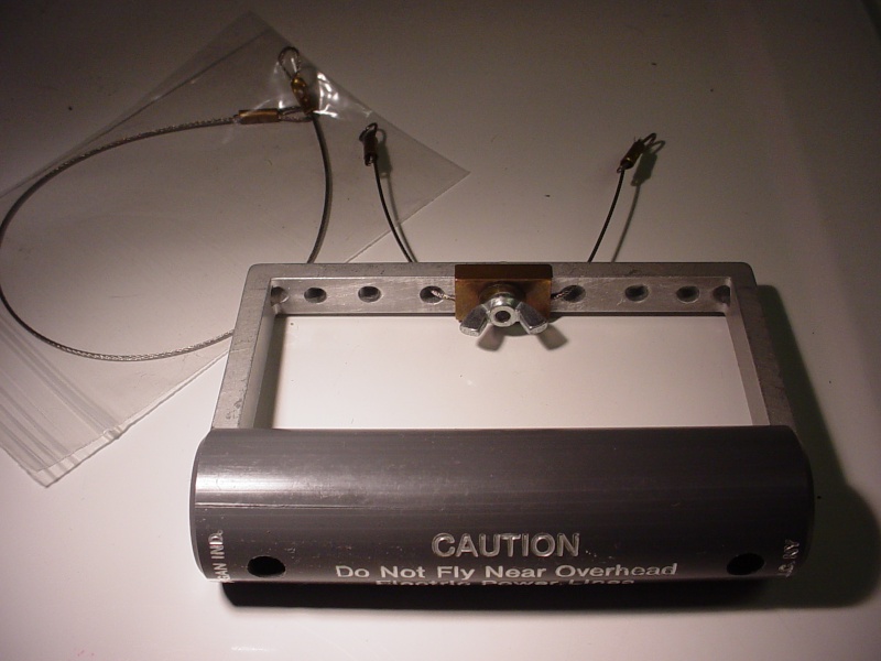

Hey Mark, I made some mods to my "Sagan" handle for the speed contest. The handle originally had only two spacing options; 2-1/8" and 4". Since I had previously made several (about a dozen) small aluminum bell-cranks with a 1-1/8" spacing, I figured it would be worth drilling a set of holes for them, as this was the bell-crank I was to use in the speed model. I also drilled a set at 3".. to cover all the bases for larger models.
I didn't like the adjustment method of needing an allen wrench.. (one more thing to loose at the field) to tighten the 6-32 button-head screw that secures the cable hold-down plate to the 6-32 tapped frame.. so I got a longer screw and installed it from the "outside" with enough thread-length for a 6-32 wing-nut and lock washer on the inside. The frame is deep enough so that the wing-nut clears my knuckles when holding the handle. Reversing the wing-nut to the outside would still require the allen wrench to tighten, as well as drilling the 6-32 threads out of the frame.
I made sure to chamfer and smooth ALL the holes with some emery-cloth, to prevent the cable from fraying. Changing cables is just a matter of threading them through the desired hole-sets which are drilled-out to .173"
Before..
Sagan handle Handle16
and after..
Sagan handle 5-18-112
matching my speed model's spacing..
Sagan handle 5-18-113
