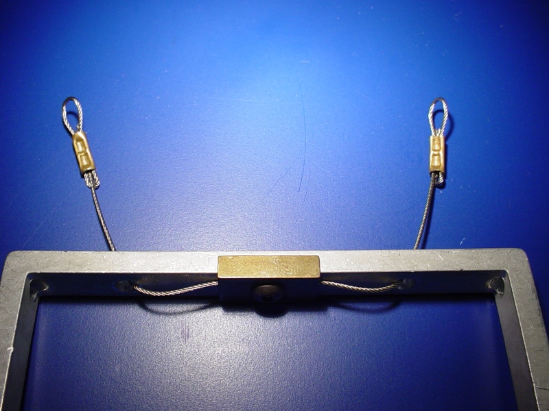

Look what I found!  affraid affraid affraid Probably not too common... but this handle had never been used! Luckily I was examining the ends to see how they were done, while making up a shorter set for my Speed contest model.
This could have wrecked an airplane...

What size is that line? It looks very large for that sleeve.
Good catch.

Cribbs74 wrote:What size is that line? It looks very large for that sleeve.
Good catch.
Ron, The line is .032" and the sleeve is 1/8" o.d. standard Brass tubing. It looks to be a defective seam by the way it's split. I replaced the sleeve with some K & S 1/8" o.d. Brass tubing that I had. I searched K & S to see if their tubing is listed as "seamless"... it does not state that it is.
I thought the spool of line that I have was a smaller diameter, but it's the same. I made up a shorter set of leads to use with the narrow spacing.

Post  Cribbs74 Thu Mar 06, 2014 11:13 pm
Excellent crimps on that handle!
