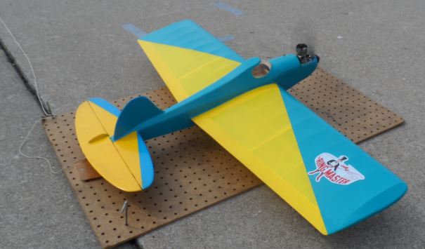

You might also think about using a chunk of peg-board for your base. I got a bunch of the stuff when the airport remodeled (I'm a shameless dumpster diver!).
With 1/2A planes and such, it works fine all by itself, and I use wire tent stakes to hold it in place for launching larger planes. It even works well when I fly from the concrete ramp at the airport, as I can select the holes that line up with section lines.
I also pack along a battery-powered screwdriver and firring strips for "side-wheel chocks" as guides to keep the plane from dancing around on the board, AND allows me to take up the tension in the lines without pulling it toward me at launch. The electric screwdriver lets me quickly move the strips around to match the landing gears of different planes...

Here is a picture of my stooge. I copied Kims' setup. I used 1/4x1 strips as wheel stops.
