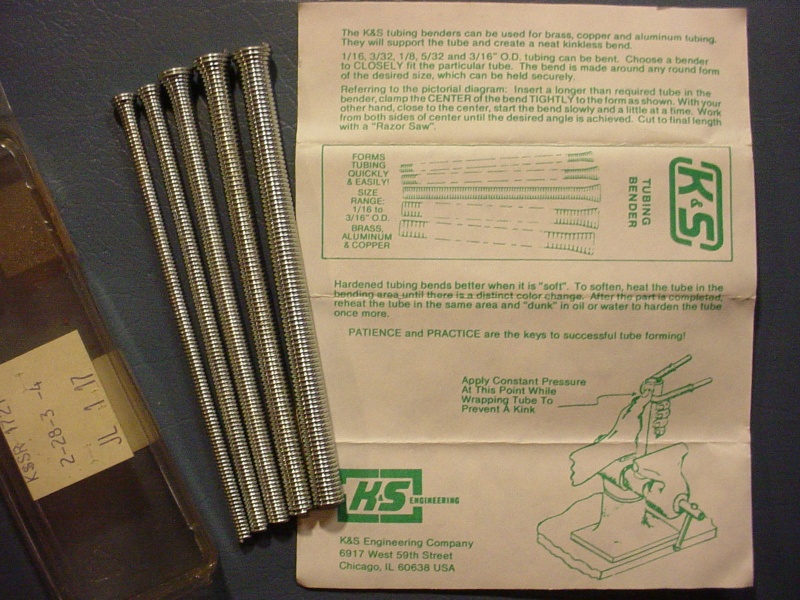

Here's a photo of a K & S tube bending kit for small size tubing. As you can see.. they're nothing really more than varying size tension springs. You would probably need a larger spring for your tubing size I would think.
