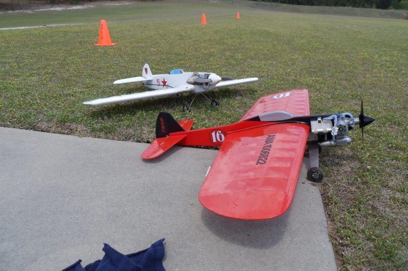

We did a bunch of flying. Wayne did one last trim flight on his eNobler that he's going to fly at Brodak, and then cut loose with some full patterns. He maidened his new e-conversion Vector and it looks like a really sweet flyer. I took the Yak and the Shoestring. Still haven't re-covered the wing on the old Skyray. I added a trim tab to the OB flap on the Yak because I cannot bend the coupling wire without breaking something. It leveled out pretty well and I got in a couple of flights. It still cuts off a half ounce early, so I'm going to get a bottom feed tank. No sense in fooling around with this one.
Best of all, I finally got the Thunder Burper running without a hiccup. I changed two things, and I don't care if it's one or both, because I'm sticking with this formula. A Sig RC Long plug and 20% nitro(or thereabouts) and it flew like I always wanted it to, but never could. I could rip it through tight turns in my squares and wingovers and it didn't care, it just ran and used every drop of fuel. If only it had run that way in the contest. I have a video of it that I'll crunch and publish tomorrow. Unfortunately my pattern flying was crap today. I've been fooling around and not seriously practicing and it shows. I was letting the wind get the best of me instead of showing it who's boss. The SS is a quick turning plane and it was ahead of me today. I need to get back on that docile Skyray a couple of times before May 3rd and 4th. I think the Ray will be better for me if the contest is windy. I can fly the Shoestring well, and did last month, but it's less forgiving if I'm not really on the ball.
But I am thrilled to finally solve the Thunder Tiger problems. It was simple. I hope I didn't fail to take advice along the lines that might have fixed it sooner. But I now have three good running planes with no flyability issues. I flew it 3 or 4 times without a single engine hesitation. It's pretty fast being a ball bearing engine, I wish I could find a 9x3 prop besides APC. I'm flying a 9x4 now. I'll just have to try an APC and if I like it, I'll dye it black. The Yak has one of those uglyass APCs too.
