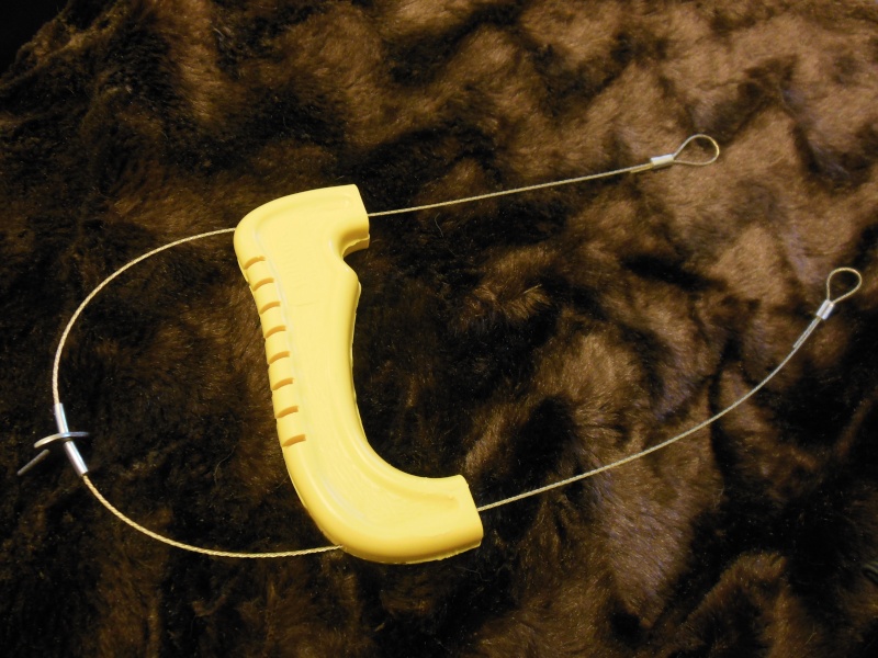

Mark had posted a picture
Ian's 1/2A Control line handle Mark_h10
and I thought - "How hard can that be?" - and so I modified the Sullivan handle.

I am now the proud owner of this very one, and it's my favorite. Though I don't think it's suitable for 1/2A.
