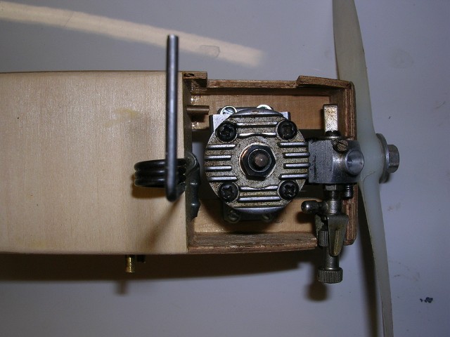

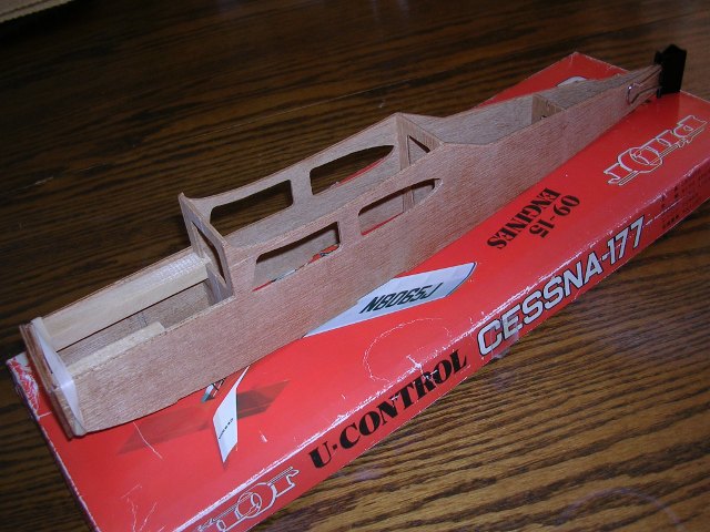

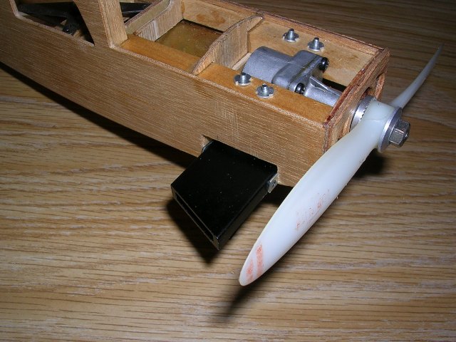

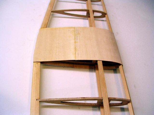

I started this one last year. I thought I'd take you through the build. It is built from an OK Models Pilot CL kit of the 1960's. I've made changes to the original. The engine I am using is an Enya .09-III TV R/C engine with throttle wired wide open. It will be mounted inverted, to give the aeroplane a clean looks. Bellcrank on the original was mounted exposed under the wing. I have moved it into the fuselage. Fuselage top and bottom planking was specified as standard ceral box cardboard. I used 1/32" (0.8mm) sheet basswood. For longer runs, I replaced the 2/3 oz (20cc) fuel tank with a 1 oz (30cc) tank.
The only balsa in it is the top cowling plank. The rest is hardwood. Although this was considered a beginner's intermediate model, I've decided to do better. Plans for the plane can be found here:
http://www.outerzone.co.uk/plan_details.asp?ID=2338
1960's OK Models Pilot .09 Cessna 177 CL 2338
Here are photos of my build starting from the beginning to the last photo, which is the wingtip leadout guide that I manufactured and am now installing.

Another neat looking build. What was wrapped around the fuselage - were they elastic bands?
ian1954
ian1954
Posts : 2688
1960's OK Models Pilot .09 Cessna 177 CL Empty Re: 1960's OK Models Pilot .09 Cessna 177 CL
Post  GallopingGhostler Wed Jul 09, 2014 6:18 am
ian1954 wrote:Another neat looking build. What was wrapped around the fuselage - were they elastic bands?
Thanks, Ian. Yes, those are various sized elastic bands. I used them to temporarily hold the basswood planking in place until the water based aliphatic resin carpenter's glue dried.
