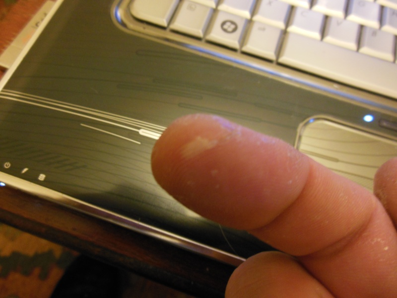

There I was modelling away to my hearts content. I then decided that some balsa needed toughening up and so I reached for the cyano.
I squirted it on the balsa and then went about speading it with the end of a paper towel.
Squirt, spread, squirt. spread................
Then i applied a little more pressure with my finger.
Big mistake - I have got usd to sticking myself together with cyano and have a release agent on standby. I felt my fing stick instantly as I applied pressure and thought nothing of it but ......
The end of the paper towel was folded over and over - and although only about a square inch had cyano on it - it had soaked right through perhaps eight layers of paper.
As I went to extract digit I became aware of heat. It felt like I was touching a soldering iron except I couldn't pull my finger away!
Painful or what!
I put my finger and the stuck on paper towel under the cold tap but it did nothing to kill the heat.
After it subsided, I used the release agent and there I now have a very sore blistered finger.
I did not realise cyano could get that hot when "going off"

Yep,
It sure does! Once it starts to kick it burns like crazy. I have done it many times. Never had a blister though. You must have held it there for a good long time.

Between 10 and 15 seconds. The time it took me to realise how hot it was getting and reach the tap. I have known mixing certain chemicals get hot - some common household ones (well common to me!) - sodium hydroxide when mixing with water (always add to water not the other way around!) - the list is almost endless but usually involves "mixing" not just a glue going off!

To do this, and it was getting hotter the temperature went over 100 deg C. The paper towel, where I soaked it with water, was warm as the cyano heated the water.
You live and learn! Health and saftey has never been my strong point.

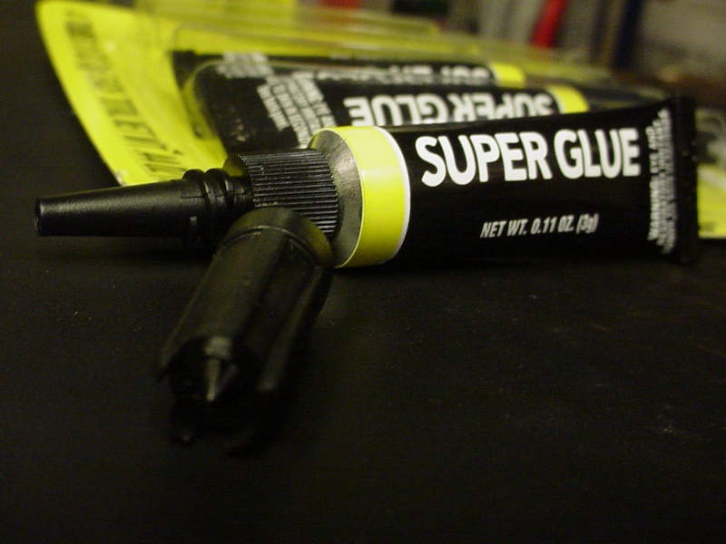

When building with balsa/wood, I use thin CA mostly.. and sometimes the "gel" formula. I also use slow-setting epoxy around engine mounts; mostly because of it's extra strength and resistance to fuel. I am quite frugal.. and buy the cheapest stuff I can find. I'll usually buy 4-pack's of small (.11 oz./ea.) tubes of thin CA for $1.00 at an outlet store.. and write the date on the package. I use-up the oldest stock first. Even if I only get one use out of a tube.. it cost me $.25.. but I have found that the tubes I buy, don't clog much.. and I typically get several uses out of each one.. even if it sits unused for months. I always clean the tip and draw the liquid back into the tube by slightly squeezing it on the opposite sides that it was squeezed for use.. and re-cap it tightly. Try it.. My no-name economy brand is made by "Henkel".. who also makes "Loctite".. although the same amount of Loctite product costs 3 times as much.
Here's what my tubes look like.. I got these at Wal-Mart.
A small slow-running fan placed beside and a bit behind you, aimed at your work.. should always be used when working with CA glue. When CA "kicks" you can actually see the vapors release in the reaction. DON'T breathe these in! CA is just one of a number of chemicals that you can develop an allergic reaction to; that will stay with you and affect you whenever you're exposed to it again. Other chemicals we commonly use in our hobby require more extreme ventilation measures.. like ensuring a fresh flow of air (intake/exhaust) through your work area. If you do a LOT of building/finishing using harmful chemicals, it will eventually do irreversible damage to your nervous system, if you don't protect yourself properly.
