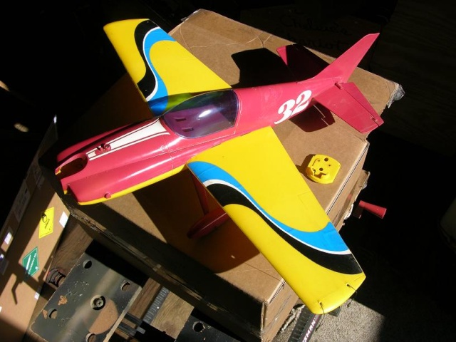

Seems that there's a lot of vintage plastic slinging about the Skunk Works lately, and Thursday evening brought yet another Golden Oldie flash-back !
My Uncle Wayne bought a Testors 'Cosmic Wind' WAY back in 1968, and we were just SURE it was gonna be THE PLANE !!  I mean...how could you go wrong ?....Cool name, cool color, even wheel fairings !!!  It HAD to be a rocket!
Our enthusiasm was soon dampened, as we watched it trundle across the ball diamond's infield dirt...it's little Wen Mac-McCoy-Testors .049 pulling for all it was worth.  With a good tug on the handle, it would finally drag itself into the air, making anemic laps until it's fuel was exhausted.  Even our official "Slow Plane", Wayne's Jetco Piper Super Cruiser was faster, so the Wind didn't get much respect.
A friend of mine gave me this one a while back, and I finally got around to cleaning the engine and setting the plane up to fly.  I had to straighten the elevator/stabilizer assembly, which had acquired a significant downward bend over the years.  The elevator STILL has a noticeable kink in it, but it works.
"Oh Yeah, They Call Me the Breeze"...er...'The Wind"..uh.."Cosmic Wind"...That Is... Sam_3410
"Oh Yeah, They Call Me the Breeze"...er...'The Wind"..uh.."Cosmic Wind"...That Is... 13_14
The engine had been run, but the plane was never flown or set up to fly.  An overnight soaking loosened the castor-stuck .049, and I just flushed it out and called it ready to go.  The plastic firewall/fuel tank got a cursory wiping off, though I may soak it too.  Check out the VERY substantial bolt/nut nose ballast!  It NEEDS it....and could actually use another one!
"Oh Yeah, They Call Me the Breeze"...er...'The Wind"..uh.."Cosmic Wind"...That Is... 16_14
"Oh Yeah, They Call Me the Breeze"...er...'The Wind"..uh.."Cosmic Wind"...That Is... 16_110
The Wind seemed to have NO down elevator control at all, just Up and Level, so I used my trusty Dremel tool to hog out a notch for a little more swing at the bellcrank .  I figured that this was a mostly psychological move at the time (my Wen Mac Aracobra has PLENTY of "down" already installed and doesn't need help in that direction!), but was glad I made the change when the racer proved to be REALLY tail heavy, even with that big bolt and nut in it's snout.
"Oh Yeah, They Call Me the Breeze"...er...'The Wind"..uh.."Cosmic Wind"...That Is... 15_14
I set up the Cosmic Wind with a rather optimistic 25 feet of Spider Wire !
"Oh Yeah, They Call Me the Breeze"...er...'The Wind"..uh.."Cosmic Wind"...That Is... 14_11
Which turned out to be about the right length...
"Oh Yeah, They Call Me the Breeze"...er...'The Wind"..uh.."Cosmic Wind"...That Is... 18_13
All four flights were roller-coaster trips, with the tail-heavy...and just plain HEAVY...racer hunting all over it's patch of flyable sky, while I tried to hit it with preemptive jabs of Down elevator at the right times.  The thing DOES look good in the air though:
"Oh Yeah, They Call Me the Breeze"...er...'The Wind"..uh.."Cosmic Wind"...That Is... 9_18
"Oh Yeah, They Call Me the Breeze"...er...'The Wind"..uh.."Cosmic Wind"...That Is... 10_13
The racer doesn't have much of a glide, of course, but it DOES have a rather gentle way of disassembling itself on contact with the ground:  The landing gear flops forward and down, releasing the rubber bands that hold the wing in place.  The gear then falls behind the wing, which is dragged by the lead-outs and fuselage, and the whole affair comes to a stop in the same order every time!
"Oh Yeah, They Call Me the Breeze"...er...'The Wind"..uh.."Cosmic Wind"...That Is... Dsc00710
Makes me look back with a bit of sympathy for the kids who thought they were gonna fly this poor thing.  Even the MOST disciplined fledgling pilot, TOTALLY following the instruction book, would have had his hands full with this pretty, flying whale !!!
It DOES look good however !

Post  RknRusty Fri Jul 18, 2014 10:47 am
That is so... cool, funny and sad. Thanks.
"Oh Yeah, They Call Me the Breeze"...er...'The Wind"..uh.."Cosmic Wind"...That Is... Empty Re: "Oh Yeah, They Call Me the Breeze"...er...'The Wind"..uh.."Cosmic Wind"...That Is...
Post  Cribbs74 Fri Jul 18, 2014 12:22 pm
How could something so cool be such a dud?
Take that Testors out and put a Medallion in it! Or keep it as is for side show events.  lol!

Post  ian1954 Sat Jul 19, 2014 4:14 am
Bur it did fly! It looked like a struggle but it flew.
That is why I was surprised with the PT trainer - when ever I have seen attempts to fly the plastic planes I have cringed. Never seems to be a joyous experience but, as a beginner plane, they may have been the first, final and never to be repeated attempt to enter the hobby.
I always wondered if the line lengths on the instructions were too ambitious. (Well not always, only have seeing some of the topics in this forum!).
I can't imagine what the experience would have been with this lovely looking model on 35' lines.

Post  Kim Sat Jul 19, 2014 6:09 am
ian1954 wrote:Bur it did fly! It looked like a struggle but it flew.
Yeah, on 35' of line, the Wind might have ended up being a "Taxi Machine" like Ken's Super Sport!  You'd definitely need 360 degrees of runway!
I think, for the average kid, success came down to having contact with "an insider" in the hobby to provide direction on what model to buy, and follow-up with instruction once the plane was chosen.
I had two initial forays into control line model airplanes (a Wen Mac Aracobra, and later, a Wen Mac Skyraider) that were spectacular in their failures, and it took my Uncle and cousin, flying their extremely battered PT-19, to get me on the right track.  Even then, it was a while before their instruction got me settled down to where I could control the plane.  I doubt I would have succeeded without their help.
My first contact with a balsa model was when Wayne let me fly his Dumas (Veco) 'Scout', and it was like stepping into the light!  I KNEW it had to fly better by just watching it, but it wasn't until I got hold of the handle that I found out what a sports car it was!
Anyway, got some more of these ancient "Lead Sleds" coming around shortly.  I'd like to get my hands on a reasonably-price Wen Mac Skyraider, to allow me to revisit (and correct) our first meeting!  So, we'll see...
Posts : 8233
Post  Kim Sat Jul 19, 2014 6:14 am
Cribbs74 wrote:How could something so cool be such a dud?
I MAY try that! It surely won't hurt the plane to have a little more weight in the snout, along with the extra power. Wayne still has the firewall from his Cosmic Wind (think the plane got a Viking Funeral), so I may see if I can have it to modify...

Post  1/2A Nut Mon Jul 28, 2014 2:22 am
Woohoo that was fun to watch thank you.
My cox version does have lead up front and comes with two props a 3p and 4p the wing has more tapper on 4p she goes well with a TD Cylinder and HC Head.  The wing is slotted in with rubber bands only in the back and has a underbelly section of plastic. Small Cox Logo

Post  Kim Mon Jul 28, 2014 6:51 am
1/2A Nut wrote:Woohoo that was fun to watch thank you.
Hey, You're Welcome!
It was actually fun messing with the poor thing. Yeah, a Tee Dee mod WOULD certainly help !
