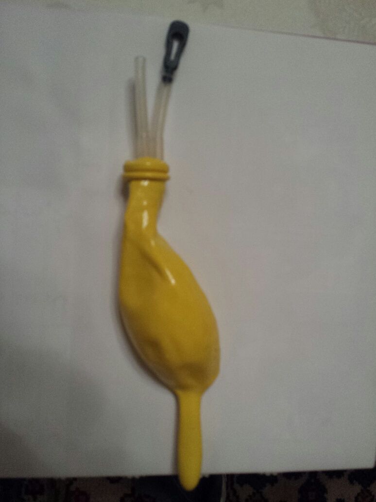

3 bladders in 4 flights. What gives? Perhaps the tubing is old? I have had it for about a year now.
Last one burst overhead, thank goodness I can sprint still!

I have old tube from my first purchase and use the same bladders for several months or more. Maybe it was exposed to something that weakened it. I keep the tube stock in the dark, but that's my only precaution. However once it's on a plane I use it for a long time with no precautions.
I flew a year old greasy bladder that was still wet inside the other day, just a discarded one in the drawer that was still assembled and it worked.

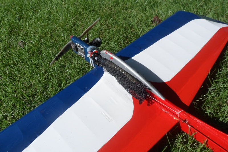

EDIT: Looking at the picture, is hot exhaust blowing directly on it. I usually put mine farther away, more or less over the CG. If you mount it on the inboard side and run the tube over the top, you have a good thumb pinchoff spot against the top of the fuselage.

You know, I never considered that. It is close, but not right on it. I'll move it and see. That's a fresh bladder in the picture.

The heat might make the latex soft wherever it hits. You don't want hot fuel if you can help it either.

UV light will shorten the shelf life of the tubing.

Geez... I don't have any experience with bladders Ron.. but I've read where "Rusty" (in particular) takes precautionary measures to have an eyewash bottle handy.. in the case that a bladder bursts while fueling.
As far as degradation goes.. I keep all of my silicone/latex rubber stored away from any light source. Were these "consecutive" flights Ron.. or 4 flights spread out over time? Are you spraying (cleaning-off) your bladder-equipped models with anything different lately.. that could be attacking or "drying-out" the bladder material after a flying session?
Maybe a "spritz" of silicone spray lube on the "exterior skin" of the bladder; where most of the expansion occurs.. would help, after a flying session?

At combat matches, we even cover our bladders with a rag to keep the sun off a full bladder. I can see how a little heat from the engine would cause trouble. Try slipping a piece of pop can between the engine and the bladder as a heat shield.

Cox made a heat shield on some models (I just bought an Acro-Cub that has one, never knew the heat shields existed).  Not sure how they affect performance.  If you need the part number and want to go to the trouble of finding one, I can dig it up.

Ken and Shawn were trying to fly a match last year and popped one everytime they filled it. It turned out to be a very tiny epoxy protrusion from either their fuelproofing coat or the container's attachment coat. Recall if i contain mine at all, I use a soft fabric mesh sheath. I have only had one pop during fueling when I was filling one of the early first ones I ever made.

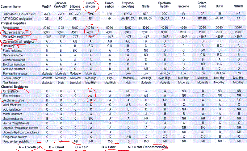

Is "Latex" the most commonly available fuel-bladder material? (pardon my lack of knowledge here guys) I was curious about the properties and availability of "other" types of rubber tubing.. so I did a search for thin-wall silicone tubing and came up with some interesting choices... but it would depend on if the tubing could be inflated and "trained" for this intended use. Then again.. if there was a superior bladder material available, I'm sure that Texas Timers would sell it.
"Fluoro-silicone" seems to have great properties for glow-fuel tubing in general. "Vanguard Products Corp."" stocks this tubing in a 1/8" OD x 1/16" ID (.031" wall) size.. as well as other sizes with thicker walls.
http://rubberextrusion.vanguardproducts.com/product/elastomeric-extrusions-and-moldings/tube-shape-elastomeric-extrusions-and-moldings?

I only know what little I've observed from our silicone fuel tubing. It's not very elastic after an initial limited range of... stretchability. I know when I have sliced it for tight fitting o-rings for my Big Mig venturis, it pops easily after a small limit of stretching. I don't think you could blow it up like a balloon as we do with latex.

RknRusty wrote:I only know what little I've observed from our silicone fuel tubing. It's not very elastic after an initial limited range of... stretchability. I know when I have sliced it for tight fitting o-rings for my Big Mig venturis, it pops easily after a small limit of stretching. I don't think you could blow it up like a balloon as we do with latex.
Thanks Rusty, That's what I was wondering.
