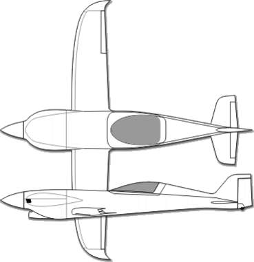

Post  Theo Kleynhans Wed Jul 23, 2014 7:44 am
Hi Guys. I need some help.
This is the first time I am doing something like this and need some advice.
I would like to try and build a nemesis. If I scale the 3 view to a 15inch wingspan, I only have 31square inches of wings. So I need to go to 45squares.
So If I extend the wingspan to 19inches and make it a little bit wider, I get to the 45squares.
Is this a good way to go? What is better to do: add length or make the wing wider?
I would appreciate the help.
Also, as the wings are not as wide at the tips, how do you accurately calculate the area?

That is VERY generally true. A long, thin wing tends to be more efficient, meaning that for a given area and a given amount of lift, the thinner wing will generate less drag, all else being equal.  I say this is very generally true, because as you can guess, the variables are almost infinite. One of those variables is the shape (planform) of the wing.
Theo, if the Nemesis you are looking to build is the version in the drawing, the shape of the wing is excellent for what we are trying to do. From my figures, it looks like if you were to increase the span to 17", make the chord (width) 3.25" and make the shape as close as possible to the original (especially the tips) you would have a very nice wing shape and be just a little over 45 sq. inches. The Nemesis wing shape is very efficient and the extra span will probably be slightly less of a drag penalty than the extra width would be.
Looking at the drawing, it looks like it would be pretty easy to enlarge the top view drawing until the wing chord at the fuselage  was 3.5", then measure 8.5" in from the tip and use that as your wing pattern. Of course sanding in a good airfoil shape with a nice thin trailing edge is the most important thing. Worth spending a bit of time to get that right!
Hope this helps...
Mike
