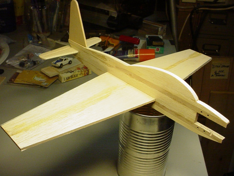

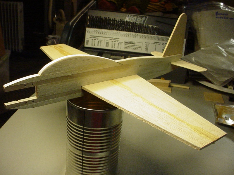

Cutting in the Sig Easy-Hinges. This method has worked very well for me. I mark the blade for the desired depth, hold it flat against the 1/2-thickness gage.. and rock the blade back and forth slightly while pushing it into the edge of the wood.
CEF speed contest Design Discussions (2014) - Page 19 1-3-1612
It took less than 5 minutes to make the six slots.
CEF speed contest Design Discussions (2014) - Page 19 1-3-1613
The knife-sharpener tool for tapering the edges takes some practice.. and believe me; it's much easier with bigger parts to work with.. It's fun to use though. The carbide blades take the edge down pretty fast if you're not careful. The round ceramic (finishing) rods smooth it out nicely after, by just rubbing the tool back and forth.
CEF speed contest Design Discussions (2014) - Page 19 1-3-1614
I will disassemble and finish-fill/sand the parts. This close-up shows how rough the surfaces are.
CEF speed contest Design Discussions (2014) - Page 19 1-3-1615
Someday I will try a stitched hinge-line.. but not today. This is a tiny stab.. 5" span x 1" root-chord x .5" tip-chord.. hmm.. 3.75 sq. in. Elev. is 5" x .5" for a total stab./elev. area of 6.25 sq. in... less the tip radii. I hope it does the job.

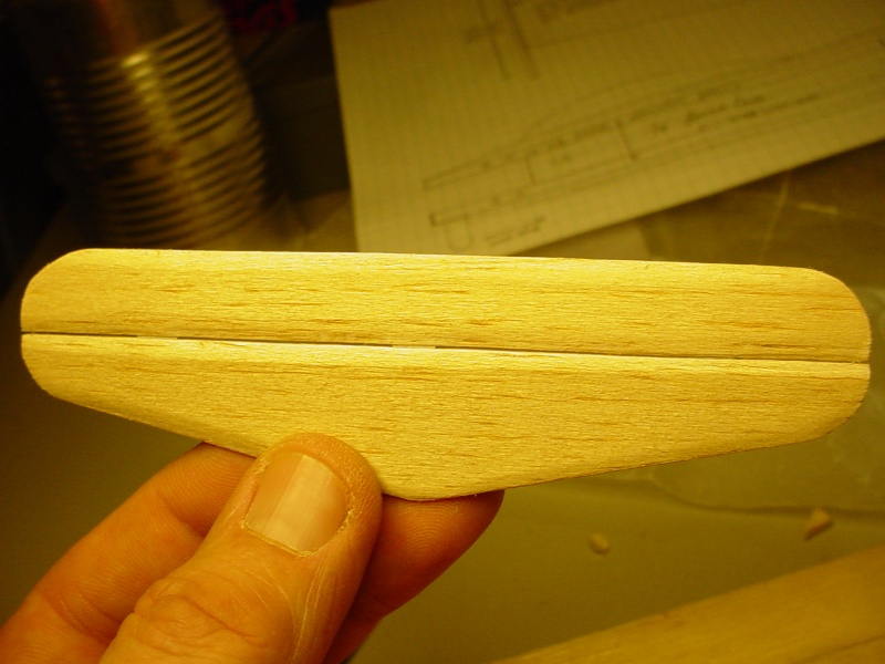

Hi all, The 1/4" balsa wing-tip-tank pieces are rough-cut and slotted to accept the 1/8 sheet wing-tip. I've cut four parts.. and slotted two.
CEF speed contest Design Discussions (2014) - Page 19 1-9-1610
CEF speed contest Design Discussions (2014) - Page 19 1-9-1611
CEF speed contest Design Discussions (2014) - Page 19 1-10-110
I was going to double these up; capping the inner slotted part, with an outer non-slotted one.. but these are hard/heavy grade balsa. It would sand to a nice bullet-shape.. but could end-up being too heavy at finish.
CEF speed contest Design Discussions (2014) - Page 19 1-10-111
CEF speed contest Design Discussions (2014) - Page 19 1-10-112
My wife says it looks like a duck.. Laughing If it fly's like one.. I'll be happy!
