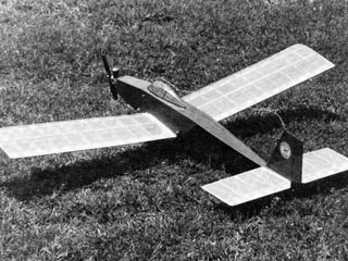

Here is a download link for a set of plans for a neat little low wing plane sport plane called a Pong Two.
http://www.outerzone.co.uk/plan_details.asp?ID=5800
Shawn

Post  andrew Sat Sep 27, 2014 10:11 pm
sdjjadk wrote:
If I build one, I'll build the wing without dihedral and add ailerons. Add a throttle like you said and it would be a fun little aerobat!
Shawn
Shawn -
With the current semi-symmetrical airfoil, I would be inclined to retain some dihedral, perhaps 1" to 1.25" under each tip.  With a long wing and 0" dihedral, the wings will appear to be drooping.  As it is drawn, the Pong looks a little like a great flapping buzzard.
But, if you're looking for a bit more pizzazz, you'll need to knock about 6" off the span.  The current area is 317; reducing the span to 38.5" will reduce the area to 275 --- with less span, your roll rates will be better.  Probably, the stab/elev should be reduced in area to around 60 sq. in.
However, at 275 sq. in., the reduced Pong is still a pretty good sized plane for the .049.

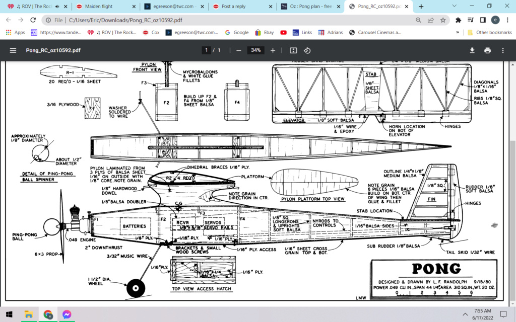

Post  kiwichristian Fri Jun 17, 2022 1:37 am
I am building a Pong 1 but I cannot see on the plan the shape of the fuselage doublers
I see the BEGINNING of the doubler, but not the rest.

Post  Levent Suberk Fri Jun 17, 2022 1:45 am
kiwichristian wrote:I am building a Pong 1 but I cannot see on the plan the shape of the fuselage doublers

Post  kiwichristian Fri Jun 17, 2022 1:51 am
I can not see any doubler. Where is it on plan?
Note: I understood. There are doublers.
Someone just suggested it starts at F1 whereas I was looking at it starting just behind F2.

Post  Levent Suberk Fri Jun 17, 2022 1:53 am
Must be trapeze shaped piece. Inside of fuselage.

Post  Levent Suberk Fri Jun 17, 2022 2:02 am
See the notches under the F3 former. Doublers fit those notches.

Post  getback Fri Jun 17, 2022 1:57 pm
Levent he said he is building the Pong 1 not the 2 witch is an overhead wing job >> https://outerzone.co.uk/plan_details.asp?ID=10592 Am i not correct ? .049 powered Pong Two Screen93

Post  Levent Suberk Fri Jun 17, 2022 2:52 pm
Because the post title is Pong 2 then I supposed that he asked about this model. Misunderstood.
Pong 1 doublers shown on plan. They strengthens servo rails. Glued inside of fuselage sides.
