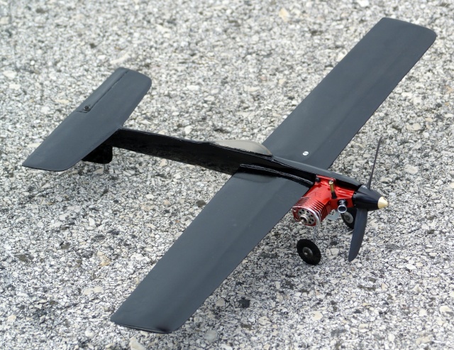

Paul's much modified Dale Kirn "TORKY" AMA Profile Proto Speed model
Hi Ron,
I even have a video of the winning flight that my wife took. But, I don'y know how to post a video. Seems to be too big of a file...
I had been hoping to do a build article of the model, as I took photos during of all steps of construction.....then the computer died! ARG!
My mods were:
Cut down wing & stab to minimum area. Use sealed elevator hinge.
Cut down fuse & use T-tail layout
Cut off rudder & fairing.
Replace top rudder with small carbon sub rudder.
Replace large heavy L.G. with small lightweight (removable) L.G.
Move wing forward touching the much heavier Shuriken motor.
Replace metal tank with lightweight bladder tank system.
Overall weight now is 5.25 oz
Performance was 96 mph in Napa this year & 100 mph w/ improved carbon prop.
Cheers, Paul

Nice!
Where do you find those spinners?? I need some 1" ones for Cox engines.

Paul is that clamp ring on the Shuriken drilled out for what looks like a Merlin style Glo Bee? It also looks like the anodizing is missing inside the venturi. Has that been opened up as well? I just got some new Boca style bearings in miy engine. I recall what you mean about them not being the same as stock. I finally after waiting for what seems forever received a spraybar that actually fits the engine. Ken

Hi Ron,
Thanks for the kind words. The 1" spinner you see is one supplied with my Shuriken, so unfortunately I don't know where you can find them.

Wow, first time seeing a Shuriken motor, I heard they fit those on the Space Shuttle

Shuriken Details
My apologies Ken, apparently my first (long!) reply disappeared into cyberspace & I hate that! SOoo here's a second try (with feeling!)
Very observant. I reamed out my Shuriken head clamp ring to fit Norvel Spirallite glow plugs. I have not yet tried Merlins. The advantage of the Norvel plug is that it is definitely faster than my own head with it's long lasting Novarossi tapered seat plug. The disadvantage is that's it's a "plug a run" at 32,000+ RPM. It would worry me more if I flew more than my usual 3-6 flights per year (one contest)...
Yes, I did bore out my venturi to .195" I.D. I was surprised to see no RPM increase on the bench past .165" I.D. but at least it doesn't appear to slow it down...
The missing anodizing on the head was from a severe crash at the '99 AMA Nats. My inverted (w/ Cox pan) Class II hit the pavement at ~110 MPH causing the entire nose section to shear off & flung into a field just off the paved area. I was lucky to have a dozen or so helpful guys form a CSI conga line as we swept the field. After 5 minutes I found the missing engine/nose section. To it's credit, after a clean up the Shuriken ran for another year before it's damaged bearing finally gave out. I had to buy ~ 10 Boca rear bearings before I found one that had the suitable internal clearance. They will all run, but noticeably run slow which as you know is not the name of the game in speed flying. MY #2 engine is a full 2,000 RPM off my #1 engine (with the poorer fit bearings). Such an engine has ENORMOUS POTENTIAL I think, but potential is all it will be... with no factory support.
Cheers, Paul
