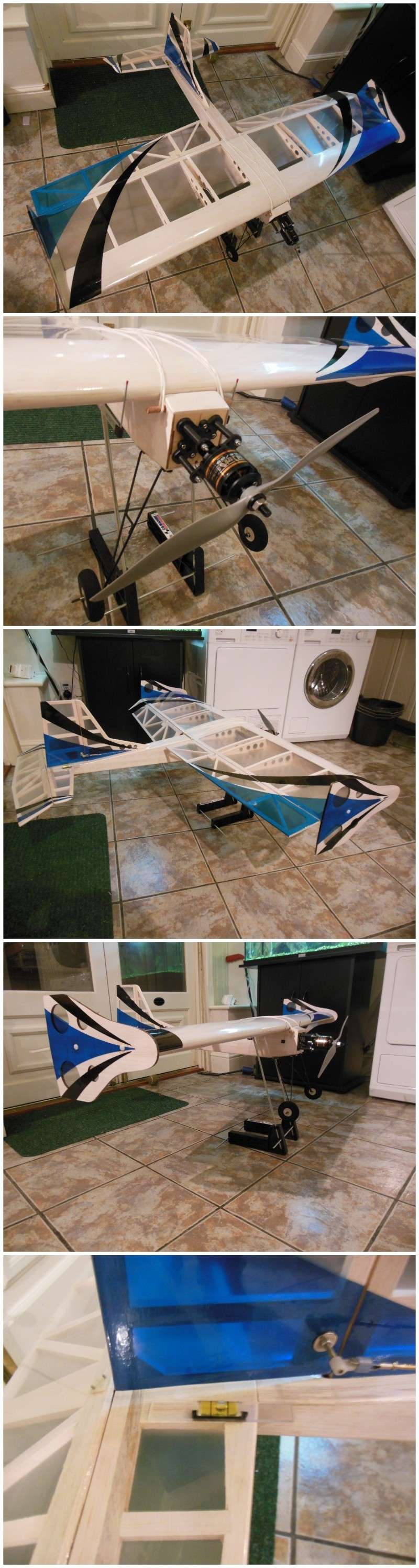

Re: Biggest .049 powered plane?
Agreed.
This boy flies at walking pace
but it is not 1/2A. More like a .40.
Wingspan is 52" but it weighs 58 1/2 oz.
As Kris says "one cannot simply give a certain wingspan and from there tell if a throttled medallion engine is well suited..."
