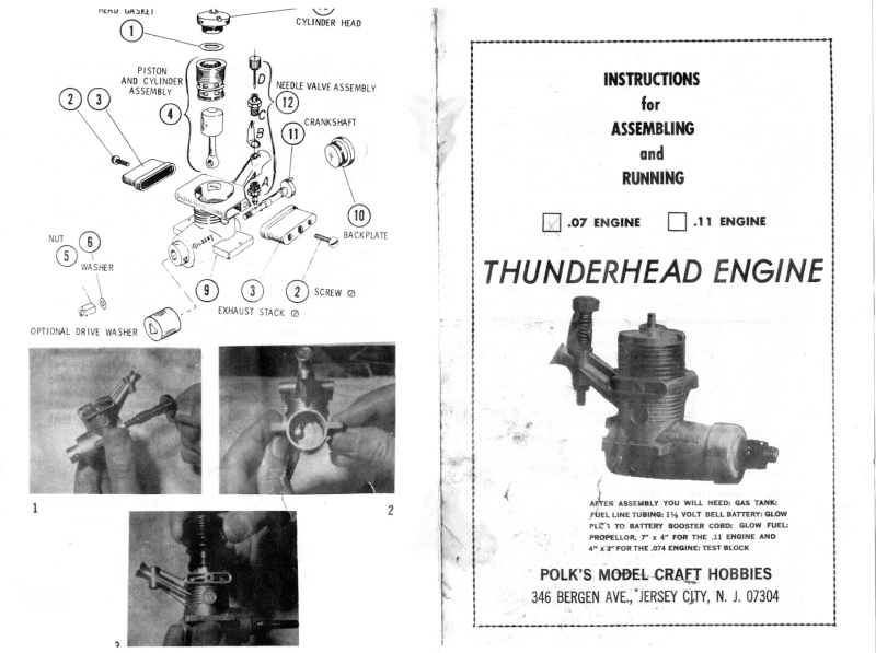

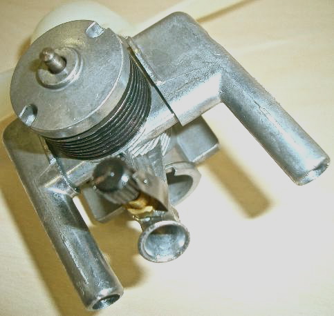

Post  Oldenginerod Thu Nov 13, 2014 7:53 pm
While it might swing backwards and forwards like a throttle lever, it's probably just a loose nut on the top of the spray bar.  They were never throttled.  There were several different needle valve variations.  Some had a press in one-piece spray bar, some were 2 piece screw in, and some had a conventional 1 piece held in with a nut.  Early ones had a normal spring under the needle knob & later the flat clicker spring like yours.  There were also 2 different needle threads.  The instructions pictured shows the 2 piece unit, but the clicker spring was the same.

Post  getback Thu Nov 13, 2014 9:06 pm
WOW way cool info Thanks Rod // The hole in it was what was throwing me off I guess no point ?? but I can fix that , any way I will need to clean all that out and see if wee can smoke some castor out of that old Gilbert Laughing Cold Leaves Cold  Some more weird weather this time of year . Wish I had those stacks on that engine , would really lower the tone . Thanks Rod !   Eric Very Happy O yeah I have the paper work for that eng. I really should read them!!!!

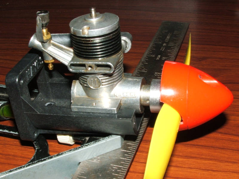

Post  GallopingGhostler Wed Dec 31, 2014 11:47 pm
A problem with the Gilbert is how to mount it and accomodate the rear venturi. I bought several discontinued Hayes small engine long mounts. Here's the Gilbert 11 with the Hayes AL-15 engine mount. This should make it easier to mount on an RC plane. I can run the fuel tubing from the clunk tank through the firewall up to the venture. It gives an option for CL planes, too.

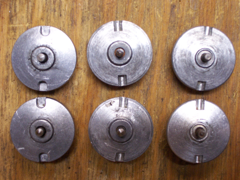

Post  Controlliner Fri Oct 14, 2016 8:45 am
You will also notice that the machined glow head has a nice trumpet shaped combustion chamber. It will out perform the Die cast aluminum one which has the poorer design. These glow heads for the 11 will fit the Cox Medallion .15 engines as well.

Post  wha-tah-hey Fri Oct 14, 2016 10:40 am
FWIW, mine turns a 7x3 MA @ 14.2K on the bench, 8% nitro/27% oil.
I bought a 6-pk of heads along with it and here's pix - note different top contours, wrench slots and combustion chambers!
I have no clue what that's all about.
Gilbert 11 Gilber12
Gilbert 11 Gilber13
If I live long enough, I'd like to put it on something vintage like the AA or my favorite, the Pee Wee Zilch, tho' with the fatter Wee Duper style ribs (a Pee Super maybe? Green, of course Very Happy).

Post  batjac Fri Oct 14, 2016 9:54 pm
Controlliner wrote:You will also notice that the machined glow head has a nice trumpet shaped combustion chamber. It will out perform the Die cast aluminum one which has the poorer design. These glow heads for the 11 will fit the Cox Medallion .15 engines as well.
Hmmm... never knew that. I might just pull the head off a Medallion .15 and check it out. And I wonder if a Cox .15 head would give any performance increase to a Gilbert.

Post  wha-tah-hey Fri Oct 14, 2016 10:24 pm
Glow heads for the Fox Rocket .09, Fox .10 and Hustler .10 will also fit the Gilbert .11, FWIW.
