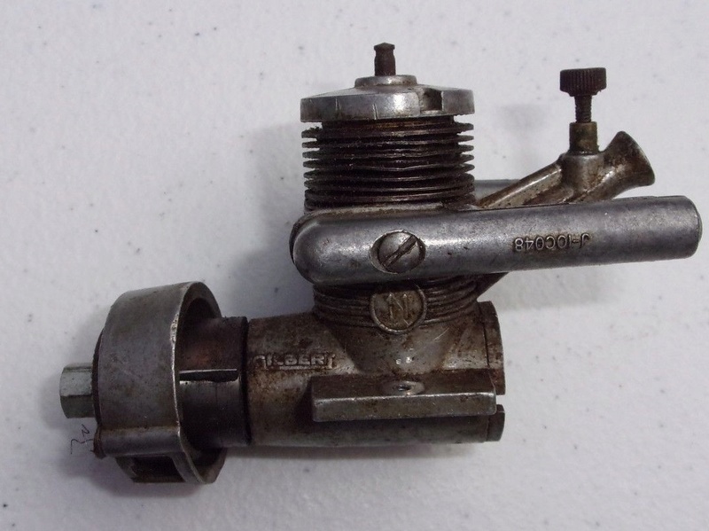

Anyway I have this rather crispy Gilbert 11 coming, an ebay buy for $8.50 that makes Eric's purchase look like a Cadillac among a group of junkyard Fords. (Sellers photos)
The spring starter is probably broken and the head may be bad, and I'm concerned about the prop drive shaft, but it's a start. I have four new Sevens but no Elevens and all Sevens being new I have not ran or disassembled any of them, so this Eleven will be a learning experience for me and hopefully a flyer.

but your find is the better deal, I will pick up a set. Do you think the prop drive shaft is broken off? Not a good view of it though.

I think your crankshaft is ok. As you see in the top picture, the starter hub is sitting forward a good 3/8" from where it should be. Also, that is a rather deep prop-nut, designed to clear the original type prop's recessed centre hub so that an original flat type wrench could be used. With the hub sitting where it should be, I think you'll find there's plenty of room for the prop.

My Gilberts (that have "headers") are matched, but this one (top picture) are mismatched. Looking over some old Gilbert ads I see Gilberts equipped the same way.

Just a note - it's my understanding that the "unmatched" headers were original equipment, to fit the RTF models Gilbert's were mounted in.

The way they were mounted in the RTF's, the prop spinner was centered to look correct, but the engine was given a good bit of right thrust so the left back side of the engine would be closer to the left fuselage edge and back off center but prop hub still centered. Thus to appear correct, muffler on the left had to be shorter. Once in the model, the uneven lengths of the mufflers would be transparent as they would be seen stick out beyond the fuselage sides at equal distances but parallel to fuselage centerline with a symmetrical look.
If one were to put one of these .11's with this type muffler arrangement with the same amount of side thrust as in the Gilbert RTF's, in say a 26" span DeBolt All American, could modify the beam mounting so muffler alignment as well as prop hub would appear correct.
