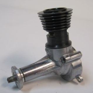

Post  cox24711 on Sat Nov 15, 2014 2:27 am
this i what i have want to fix it
bought off ebay for $2
thx greg

Post  Cribbs74 on Sat Nov 15, 2014 3:13 am
Greg,
How many bypass ports does it have?

Post  cox24711 on Sat Nov 15, 2014 3:46 am
Cribbs74 wrote:Greg,
i think 1

Post  craig bernard on Sat Nov 15, 2014 5:38 am
Good deal for 2 bucks greg you can get the prop nut and gaskets from cox international I beleive the rest cant help

Post  crankbndr on Sat Nov 15, 2014 3:51 pm
The case looks to be from a Space Bug or Thermal Hopper. There is no lip on the case, I would say this could be a 2 intake port cylinder.
Unless its been changed. I don't think this will stay at 2 bucks.

Post  pkrankow on Sat Nov 15, 2014 4:33 pm
The crank is broke, these don't have a stud, the bolt is part of the crank. It will probably stay cheap, I doubt it will top $10.

Post  Mark Boesen on Sat Nov 15, 2014 6:13 pm
It's a early Space Bug or Thermal Hopper case with the small dia. head, so it should be a dual port intake as the Space Bug Jr. had a noticeably lower exhaust ports. It would be perfect if you got a badly damaged plier marked cylinder and corroded case, but to try to build one from this would not be cheep, too many parts needed. I agree, I don't see it going over $10

Post  anm2 on Sat Nov 15, 2014 6:57 pm
tboygee is or was a member of this forum.  I haven't seen him post much lately, but he has an amazing collection of cox engines, and I routinely see him selling on Ebay.  He is quite knowledgeable about Cox engines and I am sure he can answer the question as to whether or not that engine has two or one ports.  I agree with Mark.  The crank is broken and getting replacement cranks for these engines isn't easy or cheap.  I think it is better off to buy a complete engine and fix it up, unless you just enjoy refurbishing engines (I do) and don't mind paying a lot to do it (I don't).  That is a pretty nice cylinder, and may be worth the price if you have the crankshaft to replace the broken one.  Andy
