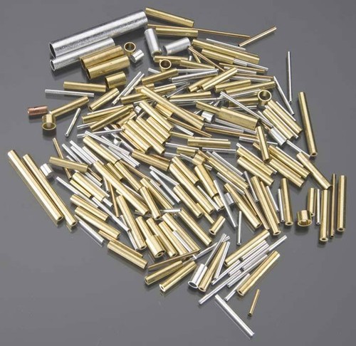

That's nice. Don't forget about the suggestion I made the other day. In fact I just bought a new package from omnimodels.com on eBay. Every size imaginable.
http://www.ebay.com/itm/NEW-K-S-Tube-Assortment-320-NIB-/291268619718?pt=Model_Kit_US&hash=item43d0f66dc6
