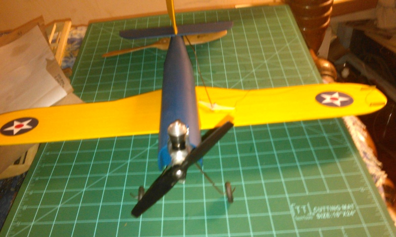

This is the plane I scratch built for the fly in Kim had started and was not able to fly that windy weekend . I will show the plane one more time even though only Rusty replied before (thanks Rusty) Then the flight this engine I had not benched tested so it was not up to par, but the plane flew very nice and forgiven just like a trainer should. ( skip through to the flights as not get too bored ) Thanks Getback What?   PT-19 Maiden Flight  Wp_20121

That seemed to be a nice slow flyer for an 049.

Ian the engine was running poorly wouldn't wind up after it got in the air / but was very stable at that slow speed Very Happy Eric

It appears there is nothing at all wrong with the plane since it will fly that slowly and stay tight enough to control. Looks like a good one. Just need to get an engine that will run now. I think you did good work.

Hey Eric, Nice job! Thumbs Up I'd give anything to have a field that big on my property! I've seen you fly there before.. but this time was different. Maybe it was the suspense of your PT-19's first flight.. I don't know. It seemed like a dead-calm day.. and so quiet until the Bee started to pop! The model seems to fly great.. Was it cold out that day? Phil has mentioned wrapping the top of the cylinder with a couple turns of knitting-yarn... although I don't think your trouble was temperature related. It almost seems like a reed issue. That backplate doesn't use the circlip reed holder.. does it? Either way.. the reed could be creased.. or some crap could have gotten under it. That's the only thing I can think of.. being that an engine doesn't usually go "rich" in the air. Is that what was happening?

When temps start to drop the castor oil thickens so the needle setting on the ground can differ
On large models with external tanks this phenomenon is really apparent. Sometimes I have to launch lean to get the right setting when the fuel is forced to the outside of the tank in the air.
Of course Eric could have been experiencing a mechanical problem, I wouldn't rule that out either, just when temps drop engine runs become erratic.
What was the temp outside Eric?

Rusty , will do on the phone camera thing, It was 51 degrees 3 mph wind and I actually cleaned and inspected the engine , but didn't test it before the flight ! I Thought the second run was going to work out but still lost power after a few rounds . Maybe some hand warmers will help I know it would me , Had my reed speed plane out there witch I have not ran since last year and it wouldn't stay running and wanted to run backwards even w/ starter spring ? That was my 16 yo neighbor , he seems to be interested in flying told him when I get things ironed out I 'll let him get a hands on , and that we would run some engines . Thanks Guys I guess I just needed a pick me up All last week was a bummer , I don't have a lot of friends and I consider you all my best even though we have never met . Thanks to the CEF Forum !! Airplane  Getback cheers
