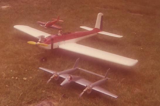

Post  rsv1cox Tue Dec 09, 2014 12:36 pm
We think alike George.  I scratch built this twin many years ago, it's long gone but the Lanier remains, my first R/C airplane.
Two Gilberts with mufflers - Page 2 Zplus001_zps1d439850
It didn't fly worth a darn.  The angle of attack was all off and it just mushed through the air.  Something similar with a better wing and CG might work as there is plenty of room for the rear needle valve assemblies to meld back into the fuselage and still construct nacelles around them.

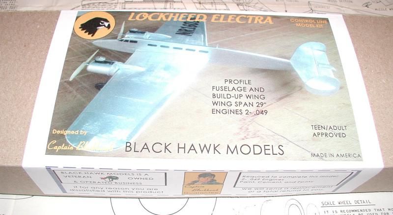

I had thought the L-10 might work but there is little room inside those engine housings.  A couple of Babe Bees might work better.
Two Gilberts with mufflers - Page 2 L10006_zps02a186c9
Two Gilberts with mufflers - Page 2 L10002_zps3f7d1747
