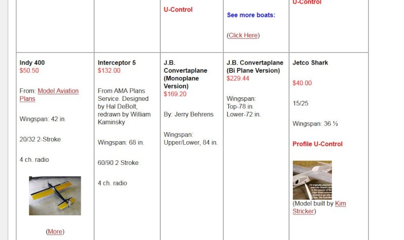

Fast Eddie (Lazer Works) has a short-kit for the Jetco Shark .15 that includes ALL the shaped parts (you provide the balsa sheet and hardware).
Mine is still going strong after several years, though it IS a bit over-powered with the Enya .19 that's bolted to it's nose, so it's mostly a hot dog-show off plane.
Also, Ed doesn't include plans, but they CAN be found and I'm pretty sure that I can find my set if you decide on this plane.
http://lazer-works.com/misc.html
