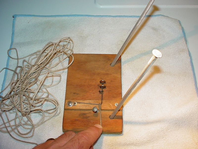

Pin-Stooges are easy to make. I love using them. Here's two that I made.
This one recently..
Will they never stop?!? Stooge10
Will they never stop?!? Stooge11
and this one about 25 years ago..
Will they never stop?!? Stooge12
Those are aluminum spikes (from rain-gutters) that I use to anchor the stooge in sod. They are angled to bite-in under tension. The newer stooge has a more sophisticated spring-return and has 42' of mason-line.
If your flying a small tail-dragger airplane.. it helps to have a block or rail for the inside front wheel to sit against.. because when you run out to pick up your handle to check your controls.. you can accidentally pull the nose of the model toward you. Kim Stricker has a cool set-up using pegboard.. so he can adjust the rail for the size of the model.

I like those roddie, especially the first one. I will have to steal your design.
