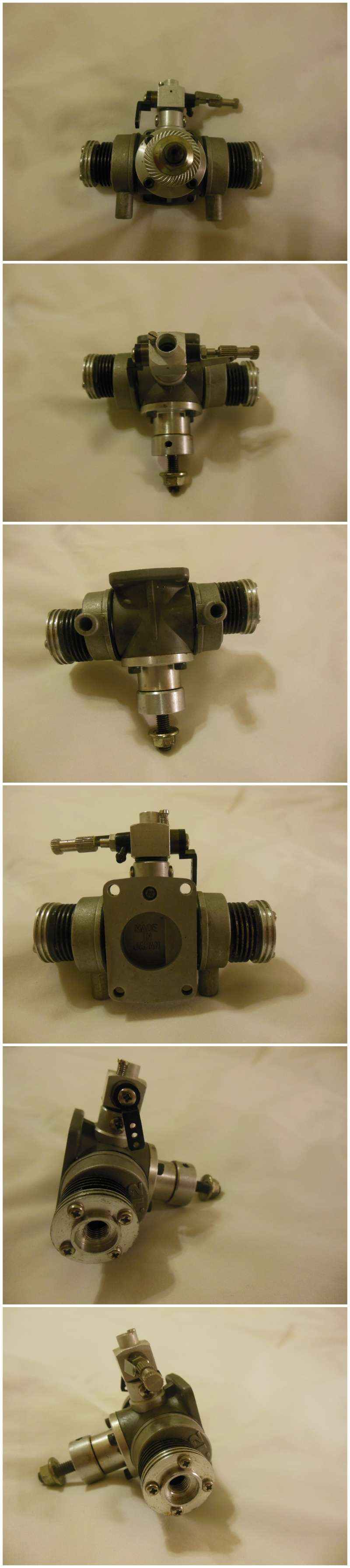

G-Mark came out with a sweet little 1 cc (.061 ci). Using parts from it, they produced a 2 cc (.122 ci) Boxer twin, and the 5 cc (.305 CI) radial in Ian's post. Cannon RC System imported them in the 1980 time frame.
There were actually 2 versions of the 1 cc, I don't know if Cannon ever imported the first one shown here:
This is the 2nd version:
The Boxer twin was tested in the March 1980 MAN. It used a very novel method to assemble the crankshaft.
And finally we have the 5 cylinder. It is actually 5 independent engines geared together in one crankcase. Each engine has its own crankshaft running in an independent crankcase chamber. A tiny drum valve is keyed to the propshaft. Fuel is fed from the carb through the rear cover to the drum valve. As the propshaft turns the drum, fuel is fed in turn to each cylinder through a hole in the bottom of each "crankcase". This engine was reviewed in the Nov. 1980 MAN.
The Boxer really screams. The 5 has a sound of its own. Check it running on my youtube page GW MOHRBACHER

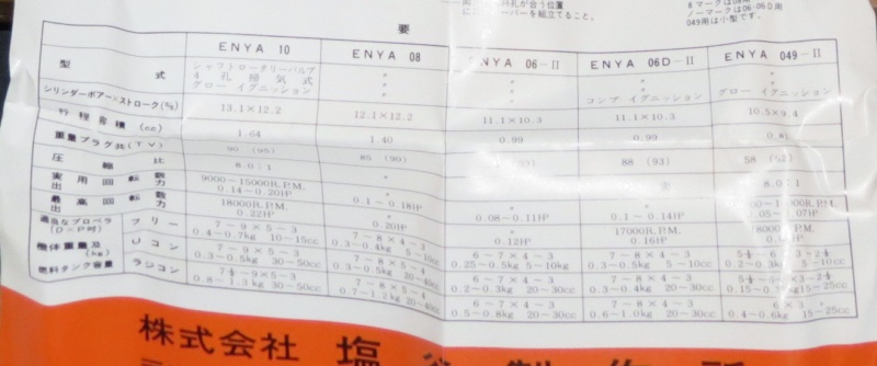

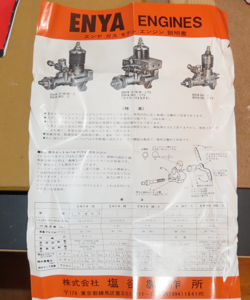

Enya did both a .049 and a .06 RC engine with optional mufflers. There is also an .08 and .10 engine mentioned in a data sheet, but I don't have any of those...
The engines are pretty old-school and use a regular glow plug, so their are really more for the enthusiast than for everyday flying now I guess.
I really like their AAC and ABC engines, these are very well made and smooth runners, they range from X.11, X.19, X.21 and so on...
Here is some engine info that came with the .049 engine:

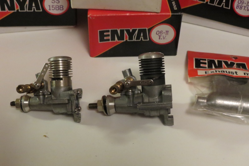

And a .049 on the left and the .06 to the right;

Thanks Kris, yes those are the ones. How does the Enya .06 compare with the G-Mark .06? Are they about the same power?

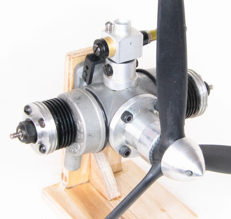

The twin is a little beauty - well not so little compared with my other twins.
G- Mark recommended 10 -25% nitro fuel for this but I found it ran better on 0% nitro and a hotter glow plug. I found this out by accident - I selected the wrong fuel, filled up my test tank and then couldn't be bothered to empty it. I hadn't fitted the plugs and had a couple of hotties handy.
It has a very pleasing sound to it.

Ian, that G-Mark .12 is a nice looking twin. It would look good, very scale-like on the front of an Aeronica C-3 cabin. Is the engine mount bolt pattern the same as with a Cox .049 reed valve tank engine?
